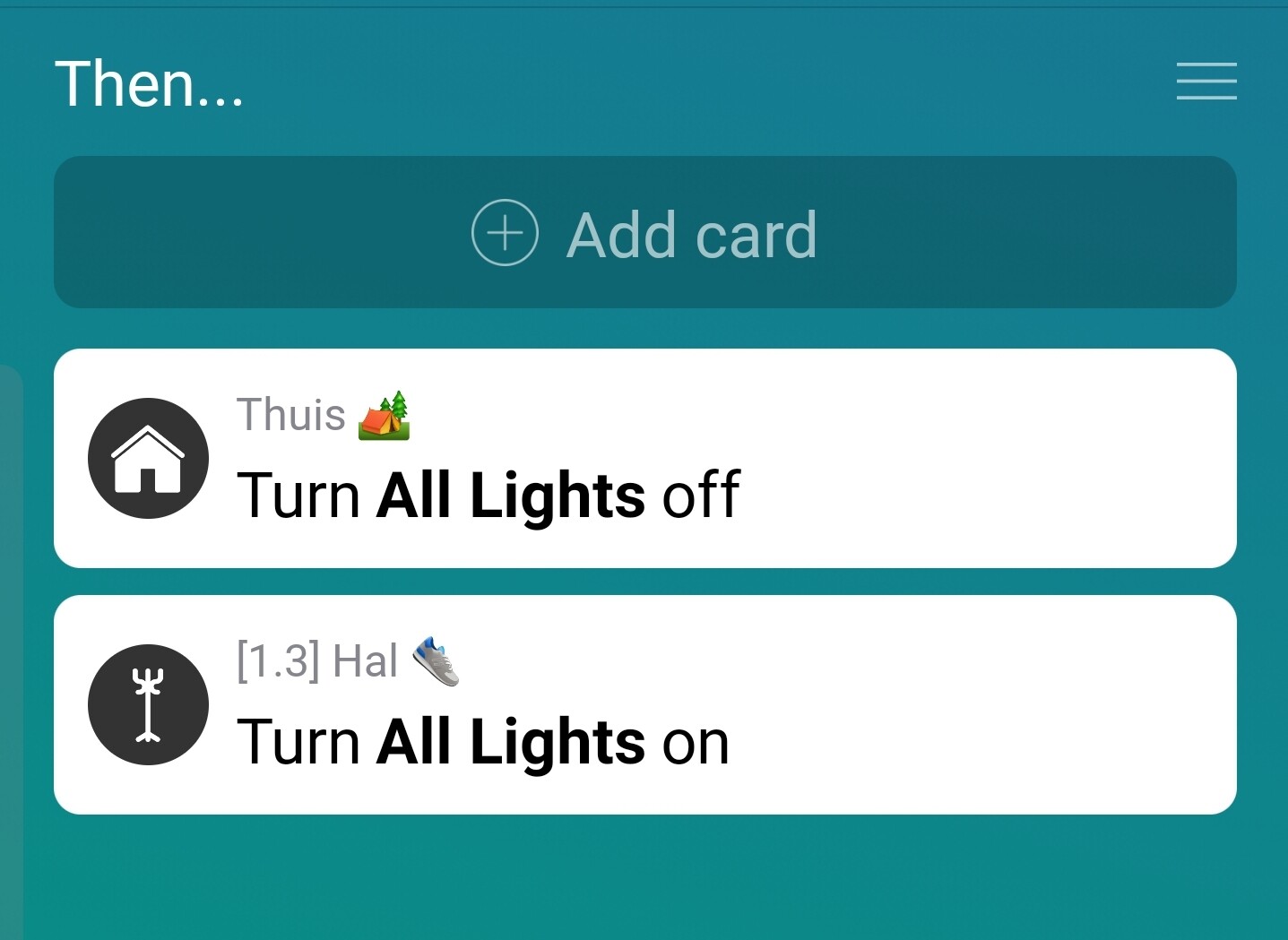

I do it a bit “dirty”:
If…
Blah
Then…
Turn off all lights
And then…
Turn on zone Y and Z after 1s
(Or: turn on Lamp Y and Z after 1s).
“And then” :sweat_smile:
Whats the fun?
That’s another flow right?
No. I just meant this with:
Then…
blah
And then…
blah
