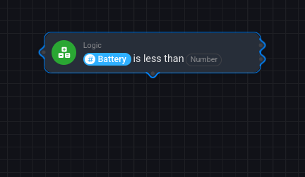

Logic not availible in advanced flow
I am trying to use logic and luminans
when I have choosen the option in the flow I get not availible?
Confirmed, it’s a bug (overhere with a Pro 2019). You could report it to homey.app/support if you like.

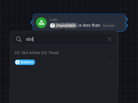

In the meantime, using my lock battery as example,
you can select the right tag by tapping it in that flow card,
and select it from the appearing dropdown list.

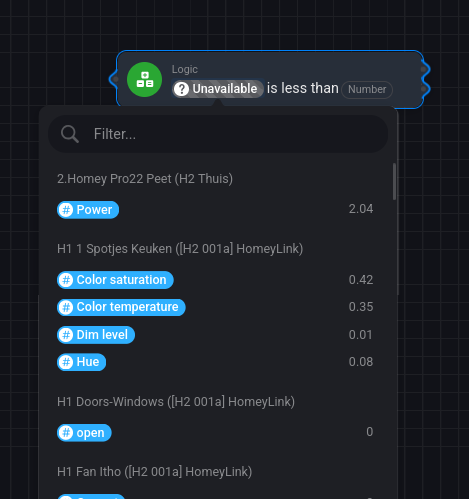

Instead of scrolling 5 miles, I use the filter bar on top:
