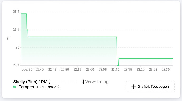

This is what my shelly looks like in insights (buildin behaviour of home, no need to do anything)
I see. I worried the Insights feature was not suitable for 1 Hz, but if it’s up to my sensor polling then I will focus on that.

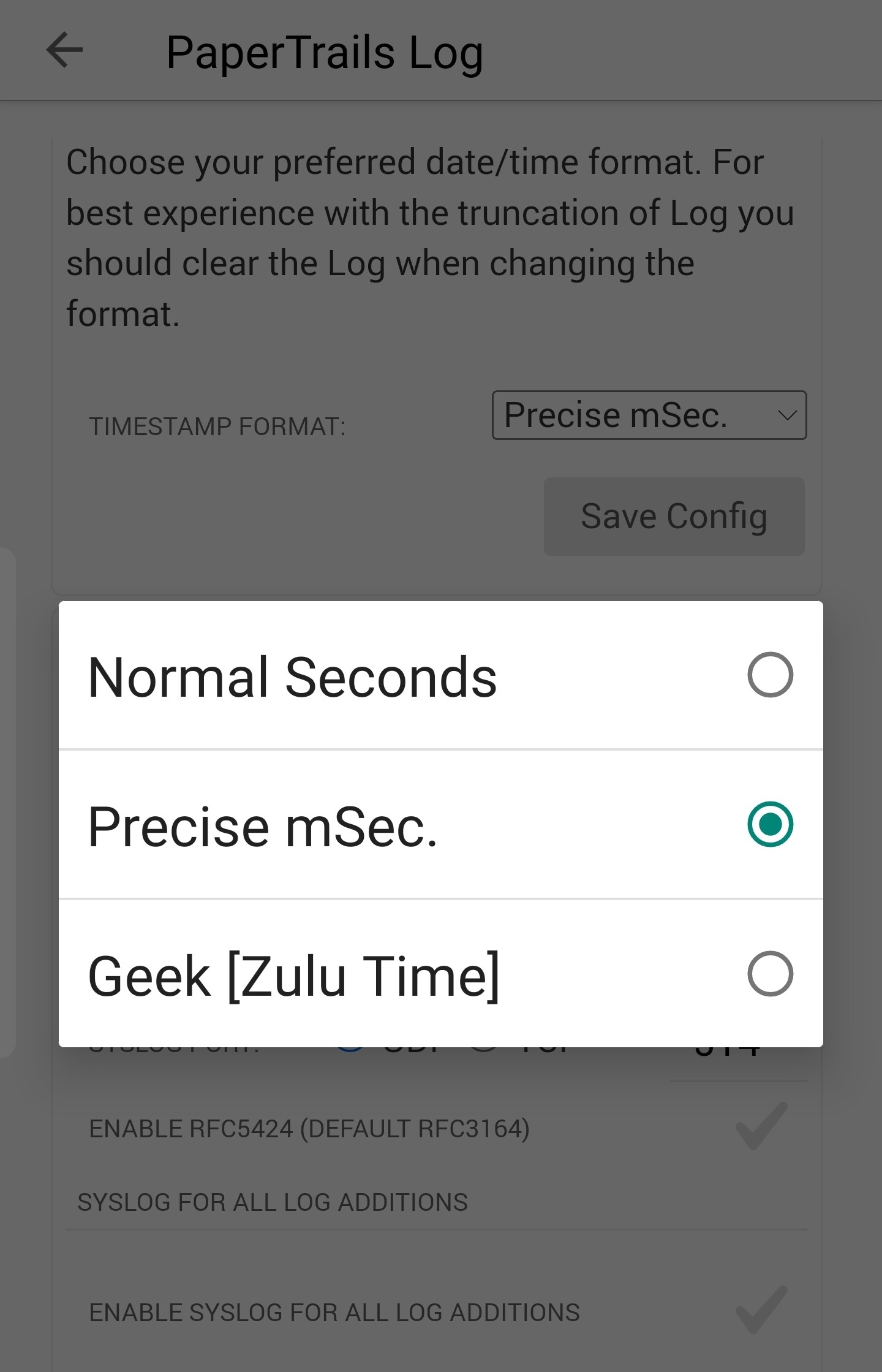

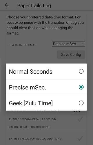

Additional: Papertrails has these timestamp choices for precise logging:
