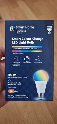

I have purchased several LIDL smart bulbs and light strips. The light strip shows up as a light strip with an icon in Homey, but the bulbs just shows up as generic Zigbee devices. I can still control them but I would love to have them categorized as lamps. Anyone have a solution?
Thanks!
You should request the creator of the app to add the device.
1 Search the forum for the app topic
2 check the app topic to make sure it is not requested yet
3 if its not requested yet, “interview” your device and provide the response in the request

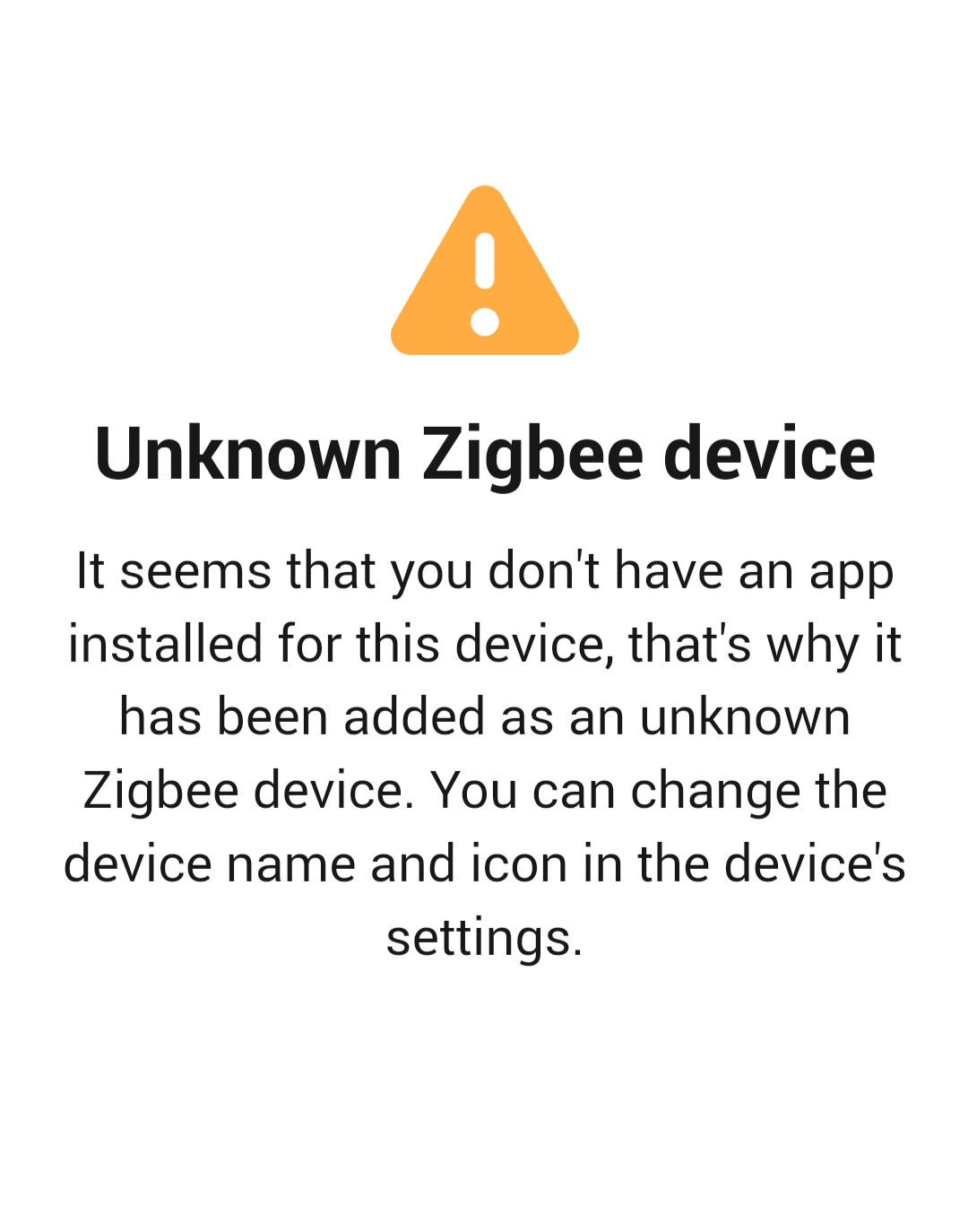

The weird part is that I can find the bulb in the LIDL app if I’m not mistaken. So I believe it already exists.
Attaching an image of the icon in the app and the one I purchased.
Well, somtimes the producer makes a change to a device and that also changes the productcode in the firmware.
That causes the app to no longer recognize that type.
It needs to be added
