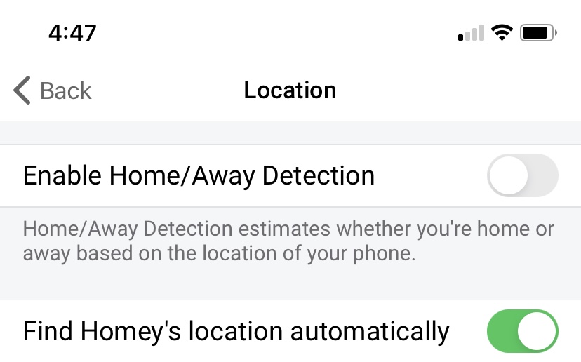

I went into my Homey Pro’s settings just then and noticed that “Enable Home/Away detection “ had been switched off. ??
I re-enabled it. It now works again.
The only thing I did today was go into the IOS sub-settings for the Homey APP on my iPhone and disable and re-enable background app refresh , and the “always” setting for the location service of the app.
On my iPhone "Enable Home/Away Detection is on.
I had to switch off: “Find Homey’s location automatically” because Homey thinks that it is almost 10km away.
