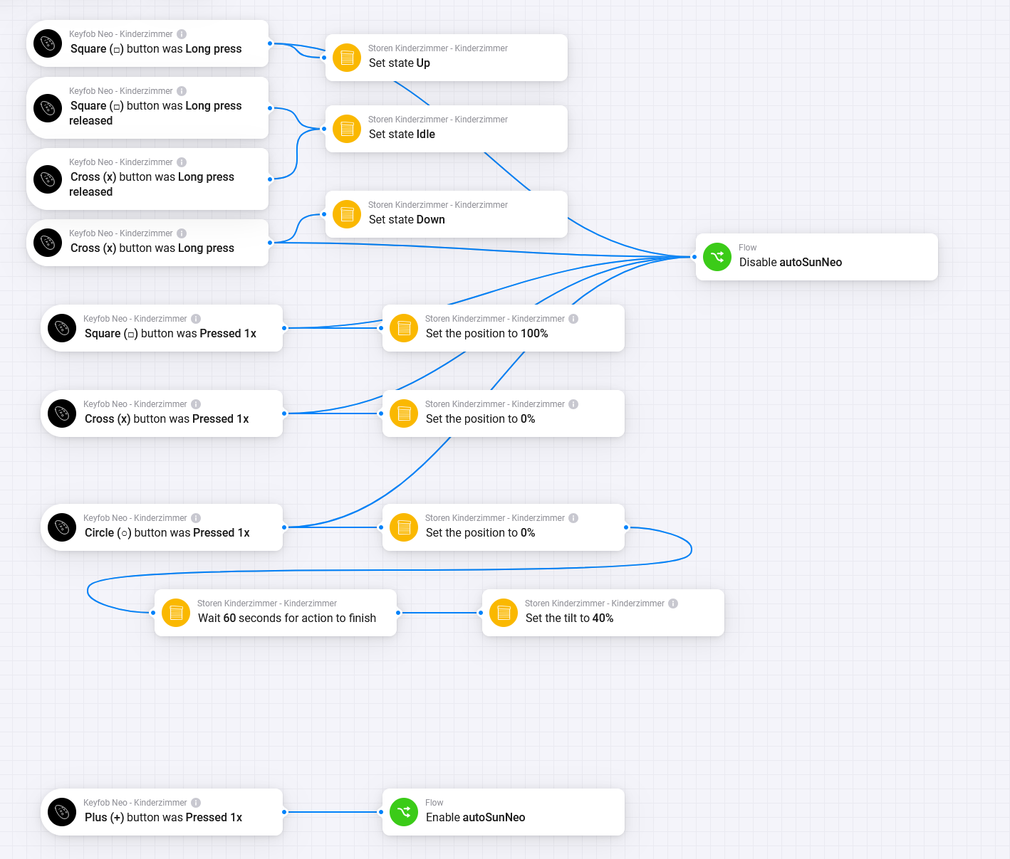

Below sharing my flows - not tested yet as the weather is bad atm :smiley: but as you all were helping you are maybe interested what I’m trying to do in the long run:
ok somehow this device capabilities sharing thing does not really work - if anyone knows how to do it correctly…
Lamellen Neo

[tef:FLOWS:"H4sIAAAAAAACA91c224cSXL9FaKxj4yZyMzIWz967V0bu1gvdgz4YTAgIjMiycaQ3XJ3UzPjGQH+CH+O3/wn/hIjqy9St4pUjSRyxH0QKHRVZWWcjPulfp7JbP7zLCYyTqlA8IGBMGZgrQ5cFAk5CiEO9y1n89mf9Ke2Khd/0dXsclZn89lqe6Pr2ZvLWROrjK6CQU9ASAo5eweJrZjMQtrwsMo329Valxd/WixF1/+5uLvT9X65crtYymZ2Odv2e39YLGX1Q1291vVieb252uj2sMRfV5vFdrFa7m6dLe/vSt/HmzeXs2oKRZIA4rgAkTWQRCuQZLHiqqlypOcvuuXt3eri//7rvy/+fbGUO90e97LR5Wa1PuzlTnlzv9ar6/vN9mqzXevyentzWOaP95vtxfHH97eUYnShZA+oiEAuIiRMAah5R41cbsTHtXi91eVmB9HtYvn9Zr+fMzQ+DSSmErIwQy6uAEk0wMZ6CIgFpXCJVM+O6x/+93/Wq9NzenM5Q20WTWGQFgOQY4XCuYFajZKU1OY8Stpa6832SWjzLXArrlMkDsgLAvctiapy8zYgxiNtq+VSl8ejfufc31zOcjLJVrRQSBpQsw2S8wFKttlTRtb2Hif96/1WVqv1xaNMtNW7V7rm7f1aD8//2zs/nZP05nJ23+/DxhRyS9AwVaDQKiSvDClhs9yoZHsk7G+r+v1PF39eLRfX69WsL/G6XyooTSsrhFIKkBUGTi0CB0pcOZUa/WGJpS6u75fX53L67t4uZ0ZczlEaVGoJiBmhEGVovgYmUyuyfVdMNufU7aFZ3n7V9PZ29cNSt1/Vm/Vqubpe86ujiP3+nZ8GBp7Nv/15tpjNZyzeppAaGAp9B8VAdqUAoynijdcqHdK+yJ/5Tm9vdflWgf08qyWKUZshN5uAsgqkwhGKZqoy/BsO6cfZ3Fq8nP00mxPi5Ww1m89uVnf601z09aLqfJIevRy2/Kufm//hj3/6AwQ0sKm6PHDIdr24vh7OZDObfzsrlKvLzoDl4oAoIaRaAjSpmrlILQZnlzNRISFlMBgQKGCHqgposBijzdmymX03IPzzrNxvt6sOnelvGd49WIGLv651s1G5MBfbxZ0OR9Ja8c1lhlajAGXnIbdKEJCTQSbyYs6Q9PaLRHISRJczY4y0gA4k5ALknN2p09KMi1UcBkvvI+k+jGStJM3nDNX7CuRMgMTdohpLztSQI+YzJEN6yUiKba1wiJBCskA+CKScGtTE1ZBzigXfR9J+GEn0LdoUHaQaE5DFzpNFQEJhzL7m4OIZkga/TCht8phLymCjRaAsCKlxAo9eo2hrHke4LXwYo0l6Y4dRxMc04CQfcASiKc/Nx3yBHU5c944AP+gzmE4nlWo5aIfeByDx1A0FARVSbII5Fren05hHFdRvTWjnh+8eoxcHr5MJa8gMppjumtUCxScCSRyct8Ko/pzecTXyMuiV1EhD9pAjOyA0DbgmD2ycoaTOonVnsp7o2cnd3XtVV3d3vJT+99Wtbh+QeaNKbJCgZB+BcjDAIRFUg7VpNJ60zC5nzcRgqjHAKSJQYQfFGYVmuWb0SVjrQTUMWrFlJ7ZYMBwaULIEhbvTxja0ZBsmskfOoN8MqvOj3i5uf4XMz779dvfKO17yta7nt6vrRf1ligf83XeDYpxklXYwDXLzvvycvPoEh5Mr89e8XnC51b7zq71rPCID00T6ICmHRfv/F9KjtinO/+VsyXf6kPvf4wi+vdfZHL+ijtEkH+gUozOd+rkxmqTmnwmjAaEpMnxqXs9kbSpCdbXc8mJ5CLHqaimHGHm17dBMkvsDNF0z8Zq3q/UQx25/f7vqwevl7HJ29TtZr15tV9/r8ndXb7XWfD5FBc/nA3hDxDBFb51Ck8MoNMvVdtEWlTu5m1GITu6Y17XyVq/e/XFUs2z1x50q+QgS91pkkt92SuS5C3qgod2ufhglrl+Y63IQj/1N79MyXDjwuWtevQ8e0IgHYivAqTSIzTkbbSLl+JbP+X67+uZ+uQubtz+9Gn6T17ysKrukyyRH/8ykOPwIKmWx+Q3JzMVKaBrBptqAbOddJQSblXJIiVqUw2HuqTT2+X3IriLfM4pbProZp4jtrsxn968Ghs1OjSMjYIKNQEZrz4gEKGLYNVuV8GD27J5hv8x8iK8YfH+8NNfzEQS5UQJD7LBok5zDZ8uH/LPeysU/rn5YDhA6b0v2xkNRNUBVMxTJDlC4UBAfjEtnENovM+r0ZEK1KQPmErqKbj3dGMFQs5J8qlY+PqnkHgUxM7mYu3DVHHseN0FijVCC2uB0sJ1nIH6ZGLZWW5XiIDrLQOwYsrMIzVtTubiSEn+Yw/6mt8qbQRFdzjiR4eIJTDYWKFoHbGsDH5rNhRPXt3mNg1H5ewLHPQbOJMHf+6T7QPCFqehJUnlGIb0QEuUg/5M445RI8wWf48DtkXpAlAUEpQBh8VC8WkDnTGNCkZKP3H5AZCG3O3950tM7RPI+2DLjocTdqixuddTL2l2av7rf3FwN7u/YYd1vdH10sibVpY5O1mll6nK2uOPr/vvNdvtqM//6a361+Iq3N6u7r+rq7uv+oq+/5te85a4yhgv/0l/aw6y9d97xuegx/1Ar21WFnKTixSCUIhmoiIVSSoaKyQYhRsqHqlD3+nrx9xtueqgKSSnRGfVgak1AvlrIyTFUV6nUgMWUI+/tI/8xzptUix7hvCnPzUdL0lfbm7Vubla3csVl9foBpeusS8X2Klc0ApQMQraqoOQxFW65Ve5Wnbh58grVUrfqSsCVqNetrVqDLTP121zV0ChAz6YDlRr7aj3ibrkaZtvqW+N/3N9sbv3A1GK8EBkwzWUgDh64aQL0prpcbbF0cKkzPqKtJxXZR7Ce8tynqjLpZcjKHqIZJIQIuDgPzZeWJUUuQU7ZiV4UP9XgXAg9vOVucQfhr8VCNtia1FJ5qMEG1JhEEbilBCSWIEVXATFEEmYbpaczjRbnRTKUTA5I/T7ISpz7+qnmrGP85IZ8y6S97LD2+xCNRhlqUo/ECNhTnvvE3OZAaEHTsBgPIfejVKyQZPABWTLb1HwKZ4JjRus2k3o4Rgid8tynSs4kljk9zS+gZvMRpylsYqgmAEryQE4KJOMqaCtqSpNiKJ+qiIgvSUUEcdHGgD0zrEC5CaRgArCjrMWayJpmlzNip9isBbWZgQo6KLk1aBUbhli1Yv0EFUGDyZm0l1OmGi+MPauK+IiK5xQwT+lML7GyO8md2dM56kJMzbDrf9zz7YPp9UmezGh6HUeS6r/aSfllDKA3l7P1bL5d3+ubif7cKU7mKYCaZLk+DqgpNunDQE1SL/tstjuYHXpx2WwUwYBaoRYNQL67pdg7+GxAJy2Z5sypzcn2i7M5Rd9idx7mxNxSKRaiZAVKipAoeCjBRauUMSYZsxJmsBKTwpozJniGkkYjNCb5DMGQAMXMkHz1kBoSl2ZJTXuPCf7Ia9HlQ3wwCadTvXDGCPzq1fzBFs53CX/sxnlvSVp373C9vXptRxMo3IXYGwEZmnu5Nys5XyGHVjR1HaZvj3SPwbZH928RWAw/ml7GvV8u+ivuFsv7rW52mdUpLzj1qjM9VUF7vEY9qef2yAG7rtu3RenBYnpnPMUmoLZHSqEhJEMVSixsWH2oeCb5PbH/ZYh+veHltcoDIu+iSiuud68JkM29sTcSWCzWhWydMzz7rvP8lBvPbCGGjzro6+2DllCLSnGCEG3qLebR9b5lCyEGH31GbyOOWkLjP2AIpwD8y/hUQ2eQSRs7Dy7DS5ID3HnIjNpcAdVogZp6yFwtOBtKK0YxHCOBQzn3rI7yOTVfWywXm5uHWDsLS4pkIAg2INcCpMQEPktxWGy0Bk9U337OZUwJim7qevFqgHc++6cfF5vtYnm9r3FPec8ek3T0Ep/ATZRqNRbxPS4zQMS1t+EE0NiiZ1+a2J7Rq8iJi/XQbMlAqA5yNhVCJotOo28hj3uT5kFv8rRnbBKjDS7DlB3vpcaO89ML6PWYBPgZlTY8NZWf3S96W0uYiN85eHU3tBMcN4uQjRigVg1wFoUozNU7rRkPGubhXopJI00jVnbKc0cre3t/t1h26qc510KJUmMCF3vwkNFC9olBMmVRx5kojzrXuG+L8ypoGQo7BErFATeH4DL1dFcgTfncu04vrYRZqCRpaoFS9kBiDPShMkAvxJYii/DJ4T+gR+t6eMli9MJ8c79cLzYPpeZts9TrcrH39PdXQtFgIbBPKj1Kjm+PqWhbrQ+2cdKTp3bA4suqo0/i4T2JYUQ8p51PN+5XjziBLRRyrhmo1GuVCQ2k6hvYTJaCMc7V9laS9uFLmiPuisI1txqRoGJP6qSe8fDae4JRcvVcQzQnPGbwY2nQH7lub396oJHjI6iw9kDFpKdPbUp6Apdjkla6nGVilJ5YFVsSEFqFzNhtg4bgnFRn60cmsKYw/YcTWJM2eKZdH9A9f1etAktdXXTtfLFaXtze/7grMbGEZKIBp6hA1QuwogWDxJkbq9bzWr/9ooz0I1WXFMWbYbYrmAaUc4CSUgJT0Ibqg8QcxkvzuDPTkxY4NQKBPneU7I1khy6A5D7FV22BkjhCYONcNq0k1fEoOX1A2qaMeP8yNra9C5R8tJUQQq4OKPZ8MRsCp9ZFVokGDzpr5/++D86LGrCadAw7elP4JF6YOusx6QSeax4mhCF/WApLdAFqzyZRYwfZ5AI1kiUR8g7DqTZJ6aVok9q8R+cVmPpccmYG7g16NreeKDboQx1tzDhok4JqG2cHjVLsqaihAorAQVoLpVq076UdR13KSZ9mGEFnynPzEXl/WnzsMEq1bwUykH3p3Su9AyAlgVhN98RTNXic10Q7Og7zotTJJLQOzPDo9M/nUieTTuC51IlzQ2mm1ogqCXzuTfDUCBKHruYCMadcudQzibHhpeiTXMg4UzJYMQykLgDn5qGU2jyRicoy3sWx1ycxWVNCaWATd+9ECEooERw5in4o0501zRiXXo4++Vh8bBzcE5sNZt+g+laATLBQpPaW4dBqsxqKzef6ZBcMvFCFMgmuU4VyTu9nd1CmnMFzDqNGKUYCdu/EdxfOQPK95ts0G2rVuvfUyXjP4JeYkVSuRYgTcLQK5GyFlLHXdlqNWRgr+1F1gnt1MmmB03SQMR9X+bh9ONr5VV7Eu9GO9U8Z7SRlDn0anmuNQFEdFHQRTKixkSGfOZ41KNJL4RxyIiY4D973pqre+cPIDDY6kZAKSWnjHcd7zpm0wGmYHOlzM85Hh8nWPSXjNG4B1ROEaD1QiQxJqPfCu5Z7IwLHepxV23XRpBfDOBL7Z3IQkHv9OJQKqQYLhJWcwUK+jTKOPTLOlAX2jEOj6HwGxumdTKHVCKy900mbg0yVoblclWMI3pXx/Ep+SsaJbEWjDZAkZqDoe0WvT1xXWxQdUfXmLN/gX1gBYhLyexIPxx+evfPqpJnqbW14X4nA8UYql9HZ0t2v1HucKxdIvhFUTp58yRwDnYr92eE9X2cFNaZhWCyrVyBxFbKIANVQcv94gzR+pLPiiMhjXRXN2BIb9lR380DBECTJBP2THAG7NBR/Juj+s1uISRL1/II+Cf9TbOj5g9wb3rxjHm51s7na3vDy4bLelBM/gH1c+Ggbju0HUxsbRroaBrvqikrzpfTe/wjUikLGXEHRiKs9u1/tWY8TvZQMQjRepA8Fh5RM/yBShcLYIDfJkmpQHO/wPdY3Ji1w1uz02bsAWTQHLQzG1dynTQUSNQHbxERtFQ33E24pO43WQJTam9X6Nzk8W0DfWrQmYTMPBAb4lNI7afdnrYLPP8H5SVMm+NXQET7pAM5HVZ994u5zUGpT5BBaAUxpSDsqFFu7zvDJNs1Izp/qDPdydIbHvghD5tiAKFrg3PtagmneppaM8PB1V7SRtILE7r8YUWBWhUjR1BJ9QvxA6RSzOCoChntLQ58kKBQy1MC+V4Oib+4Uw3Gj9mXmJp8axaEkMuklpxk9F16WajG7r+hNQOmUTqKXpVjM7sssysIGoTcVAFVqfZo3QTA5J61sgj9zRcKLySGh1Vh9LmCbKX1cqHtoLgJz0IzRq33nu4NjqYDGEopqg5hU+7RmBc6UIXGNOTlkPfppx/J6+s1jwffmah4IB7XaqMUpJCQG6iM1xTFDay17ta44OdOG8Uur1DzB4Zs0zOFNefo07xyfLlZe3y+XPWx9MK6ZwqePRssfHkN4t5fNl9QyqQVprufDxQBbSVAc2czWoEY9aXA8m8d6vjyC996zCb10wKl3zGZIuX/G3YZqWhOLioMfH9W3kqEU6l2nzUJBa6FJ62XmlizVTwWw+x8JS9CA4PzQbGEZshULLpXaDDX05Ty3lPGF+eVD/FFFjCULKliBfKyQHSWQkp2rWJo9TnId6UwvzCsf2q+mcNdBg/5mrUW/NksyiUsnHvLDyZSJQneKXv7sifanIPa5+h3fvPnuzf8D1psS5zNqAAA=":/tef]

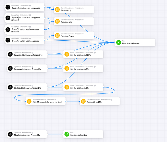

Lamellen Neo
Other things people need to do to get it working correct?
TEF:
[tef:FLOWS:"H4sIAAAAAAACA92XW28bNxCF/4rBZ03By/C2z0FaIEVRNI9BYAw5Q2cBaTeQ1nFdQ/+92JXd1LJhK0GROH3Qi3jb85FzeHijWHU3KiY0TrBA8IEAdcxAUh24yBxyZNR66TeoTr2R6zaWs99kVCtVVafG6YNs1X6lGlsh7SoY7RFQo0DO3kEiyyYTozR9N8vbadzKcPamH1i2f/WbjWxvpyvrfuCd2u9XilT37kb1qlMhOx18SKDnCTEgQsqRoRadpYRac2pqtcz8K21kvZbh8xfeqFoiG7EZcrMJMAtDKhShSMbKy0/mfn+qzlq9UteqQ61XalSd+jBu5Lpj+dRX6U4CtVo++YvHda9/fvMagjawqzKIWqlJdWra9hcXC5yd6t6pgrm67AxYKg4Qk4ZUS4DGVTIVrsVotVIsjIxCYHTQgEEXIF0ZJFgdo83ZklHvF8I3qlxO0zijM/Mqy9rLNp/9vpXdTvjMnE39RpYtaa345jJBq5EBs/OQW0UImpLRhOjZHJH09kWSPAnRSmGploLMC/gAyB4hu4KABUU31jkW95Cke55krcjN5wzV+wroTIBEc8kYi87UkKPORyRD+pFJJkJdQyYwxQRAVwsUnxA4UXDeMmnxD0na50lq36JN0UGqMQFaPZ/JwsChkM6+5uDiEUmjXyZKm7zOJWWw0WrAzBpSowRee4ksrXmNDxmF5xmd5BsHRlE/5YAnmfwjiE4Z1131A49Xdfwk23642J3vZLrlRHXqx0HdKn+sX2dmnSeV632dj/vT99Y5H4f3T8nVs9yTauq+3MdN5CXIVTk4Y43zUFMpgEIGsrcOqLjgM2VTq6jnoZxURPehHPvBhga6kG3X1uPVPdn/buhkoLKW89tOD4/p0tDdqJ7nK6F58T540IY9IFkGSqVBbM7ZaBMKxTnC0GYuY7qcxreXwyHDTNcfl//4Ew1VWO1nlSe57kGlMXiQ6fRXqOR+9x1lZifGoWEwwUZAI3WObgEKG3LNVkF9Z1z2djNfZnDzVQc/Dy/NzcEJITdMYJCcLtI45/CfBbdfZM1nr8arYfF+523J3ngoIgawSobC2YFmKhjYB+PSEUL7Mq9HjyZUmzLoXAJgoQYp6QgGm+XkU7X89enXPQkxE7qYUYOtOQJ6TpBIIpQgNjhpEo0/gvgyGbZWW+XiIDpLgOQIsrMamremUnElJXr+hP0ha6HdUqQrRQkNFY9gsrGAcbZsWxv40GwulKh+DmB3hvt/guOegnNS4R/ghNt0+u0DyU6m8wcX6kSTPGr4h5ZOXX5cFJ5UlUcK8QeRyHf1f9LJuC/S/Cj72PP68Eo4KYAdRLp0Z3LfPk5SP523cXt+UHM+jeetH/rdh0dDZW2cmJIGNobmNGggudhAbGkcJUUX4j8lPb+XxstJdWFJkieNPfBI+P14HG341K+/4Nmkf8L9fr9/v/8bvK75GQwUAAA=":/tef]
ok so this seems to work - just 1 time when I long pressed the one to go down it stopped after a few cm, ill try to catch one of those for a log
