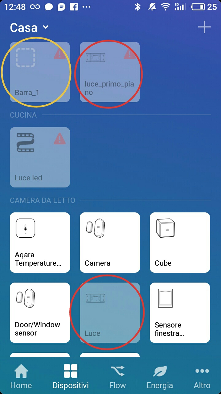

On-topic sidenote. When adding a generic Tasmota device the icon doesn’t show up in the Homey app:
Screenshot_20200119-141351
Confirm, 3 mini installed for now and 2 of them with basic tasmota and one with general
But all work perfectly thank again for this app
