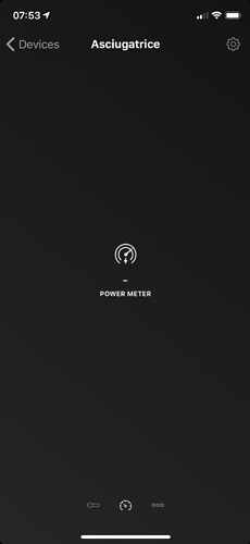

Hello. I’ve bought an AWP07L module, originally have a tuya firmware and with tuya-convert i’ve Upload a tasmota firmware and now is a module with tasmota and work very well.
I’ve correct set my MQTT brocker and in webgui i view the correct powermeter parameter, but in homey app I don’t view the power meter parameter, and is necessary for me for the flow.
I’ve set my module in tasmota-generic.
Thanks for the support
The power meter capability isn’t supported, I’m afraid (it’s shown because the driver knows that the device has power meter support, but actually reading the power meter data isn’t implemented).
