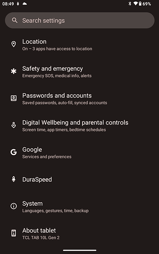

What does the “About” say in settings menu?
My phone says: “About phone”
My tablet says: “About tablet”
When your tablet says “About phone” it can be the cause of your issue.

The tablet shows as a tablet in the settings of the tablet itself. Not sure if i can check in the homey app what it detecs the device as. But it seems like this should not be a problem..
