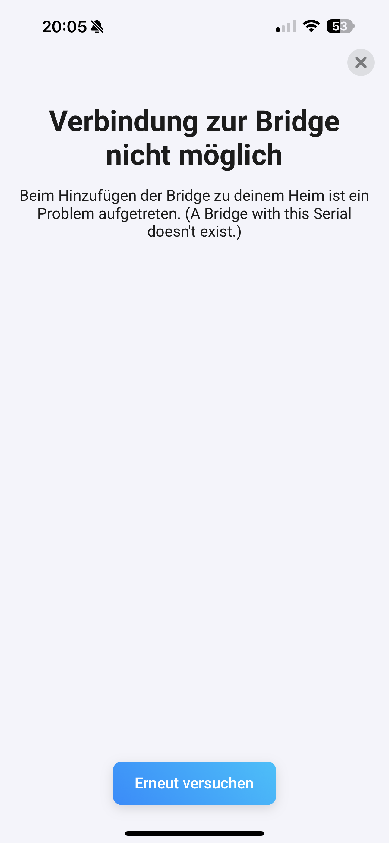

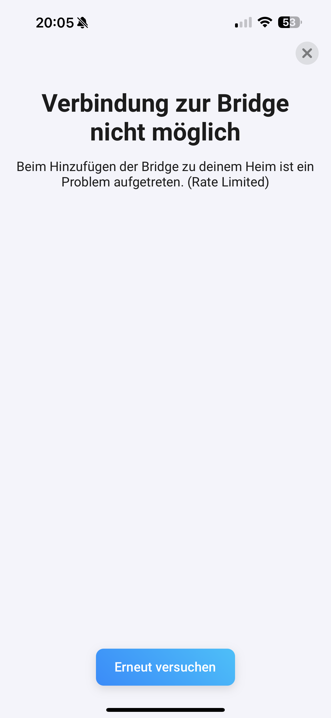

I´m trying to connect a Homey Bridge to my Homey Pro 2023 as a satellite.
When I start to add the device Homey Pro finds the Bridge. So far so easy.
Then I click to add it and it asks me which location within the house I want to assign it to.
Now it becomes strange.
  1. When I add it to Home I get an error “Rate Limit”.
  2. When I add it to Bedroom I get “A Brdige with this serial doesnt exist”.
After starting up, the bridge breathes blue. During setup it becomes green. After the error it starts to breath blue again.

All I know: in general, Homey rate limits are getting removed after 24hrs
After 24 hrs same story. same issues. will send the bridge back and order. a new one. maybe something is wrong with the device itself and not homey.
Finally it turned out to be a hardware issue. Athom support replied one day later (not 2-3 weeks as automatic reply indicated) apologizing for that.
Got a shop code for a Bridge for free. 48 hours later it was delivered.
