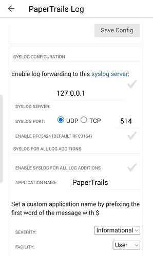

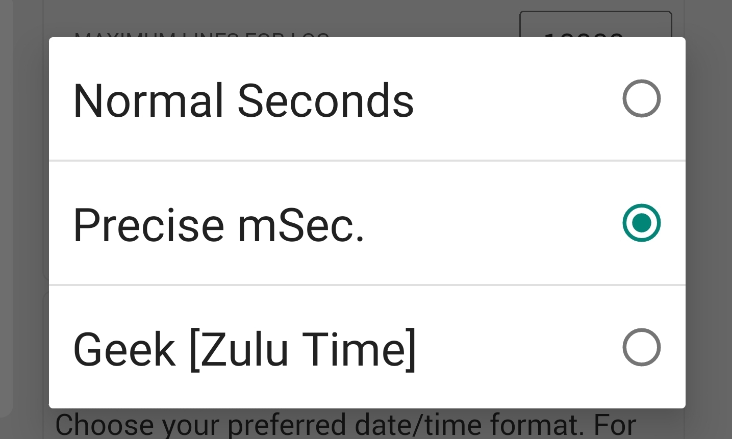

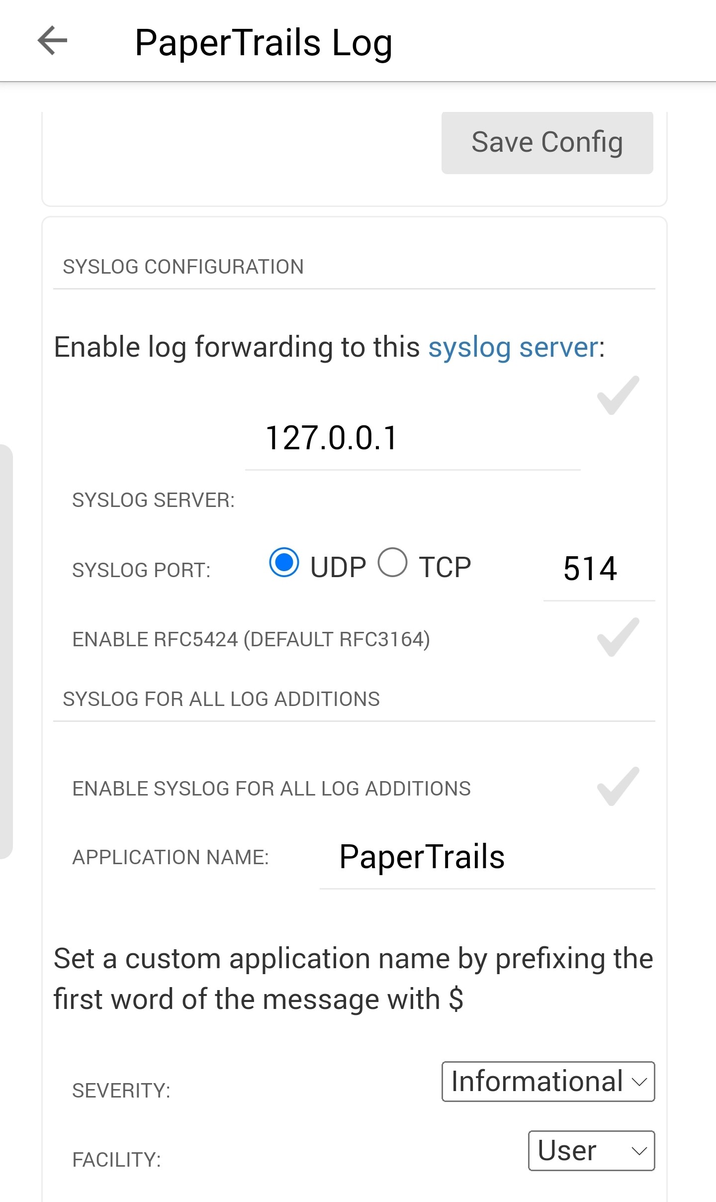

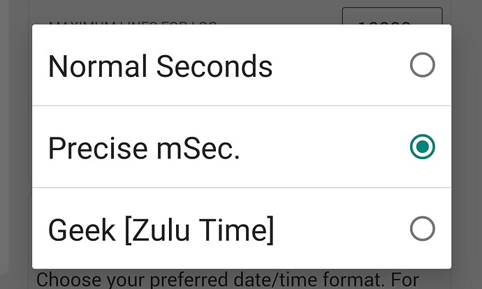

Did you check out the Papertrails app?
yes but synology itself does not show any seconds, so papertrail indeed does send it but this is not shown in synology, so if i wish to see/use the seconds i need it in the log itself…
