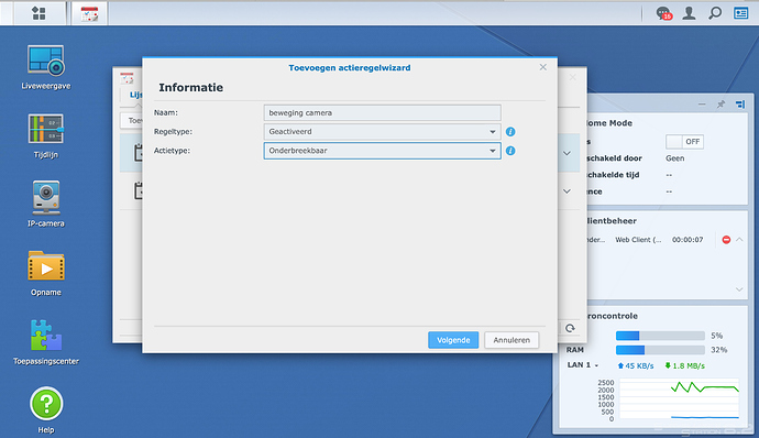

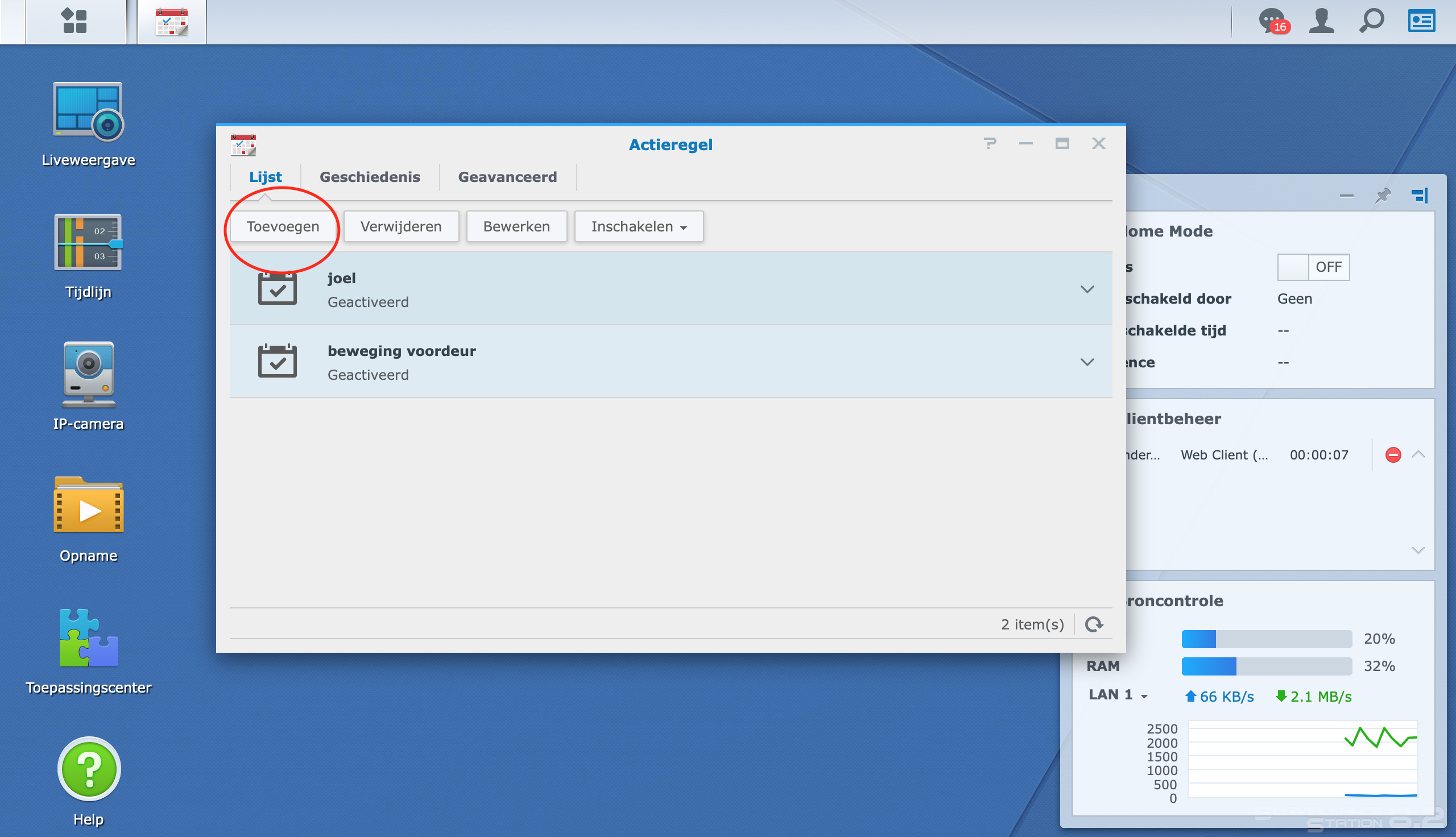

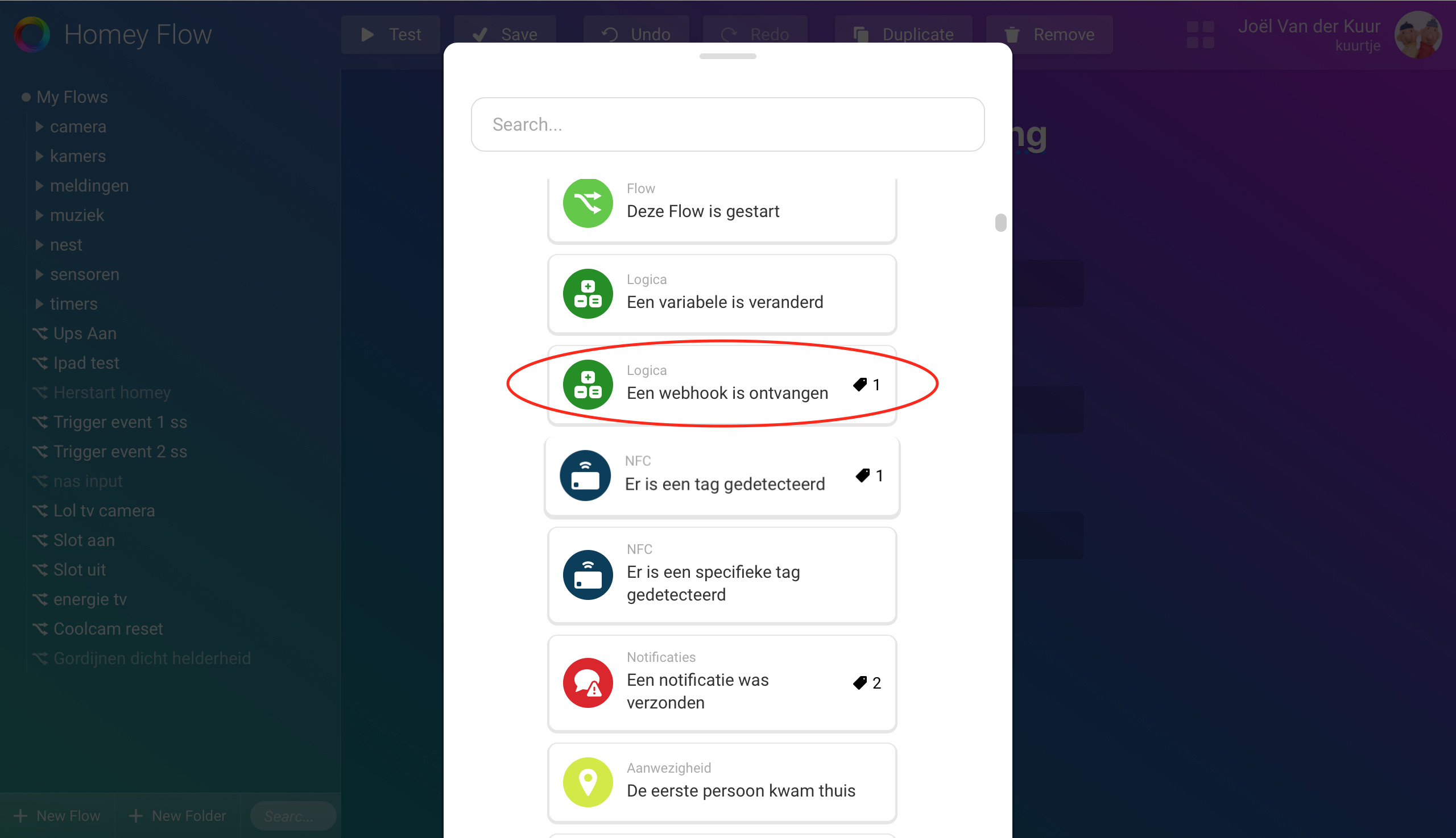

You van use events on your synology, make aan event, when the camera detects motion send a HTTP comando, and then use in homey the logic app, when a webhook is send.
oohhh, this looks so great! trying it out this evening!
how to use webhooks with your synology surveillance station.
it also works reversed with send an webhook and on the ss when a webhook is received.
s absolutely great, would be great to post also in the synology post, for those looking to get alarm notifications!!

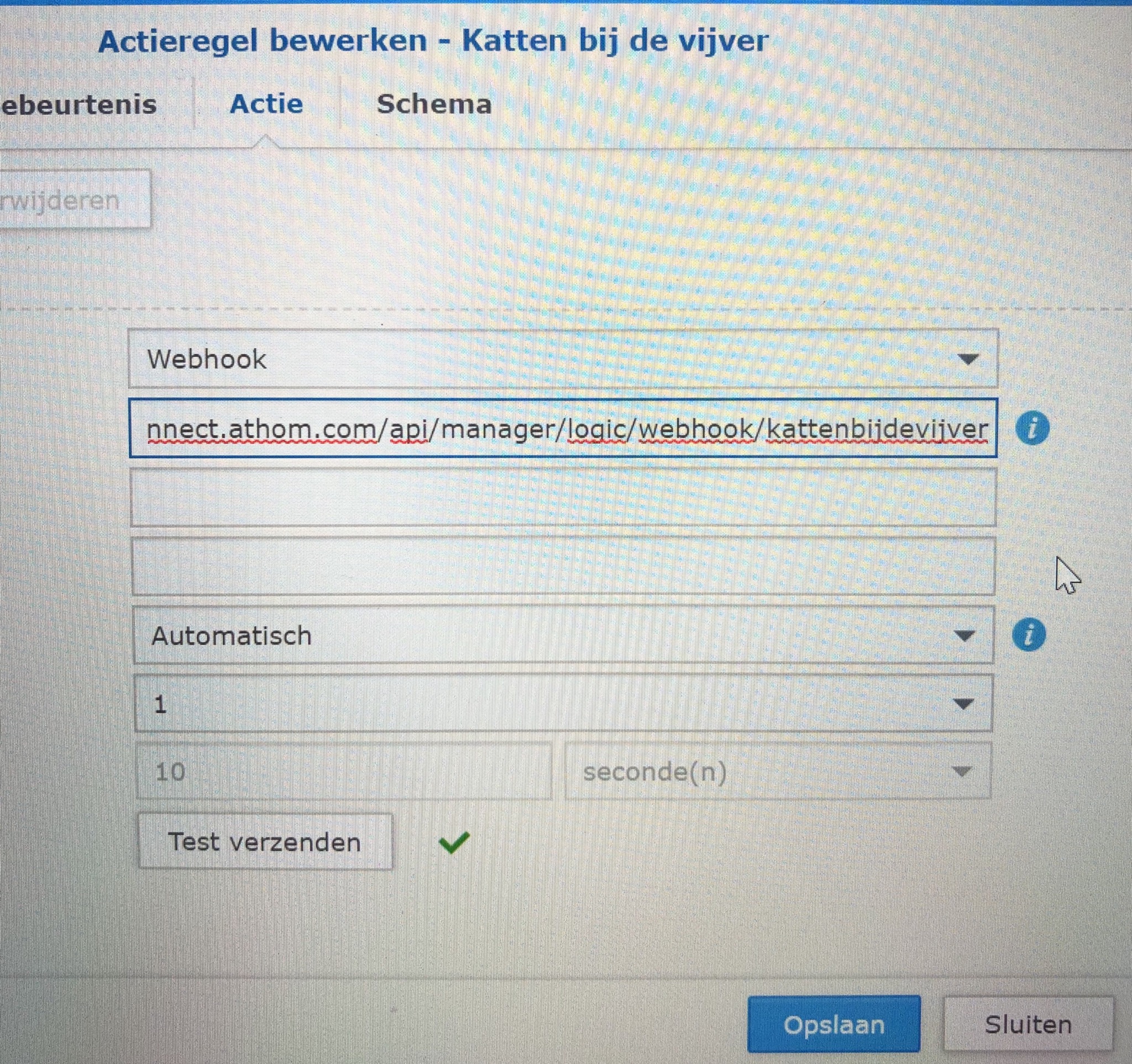

I now look into the reverse, send webhooks to the nas to activate/deactivate the movement alarms, it also works great!
Just tried to do this also. But couldn’t find External Device. Don’t know if this is different on different Synology servers. I only have the option for webhook which ofcourse does the trick
its a software update from synology. I have the same now;)
