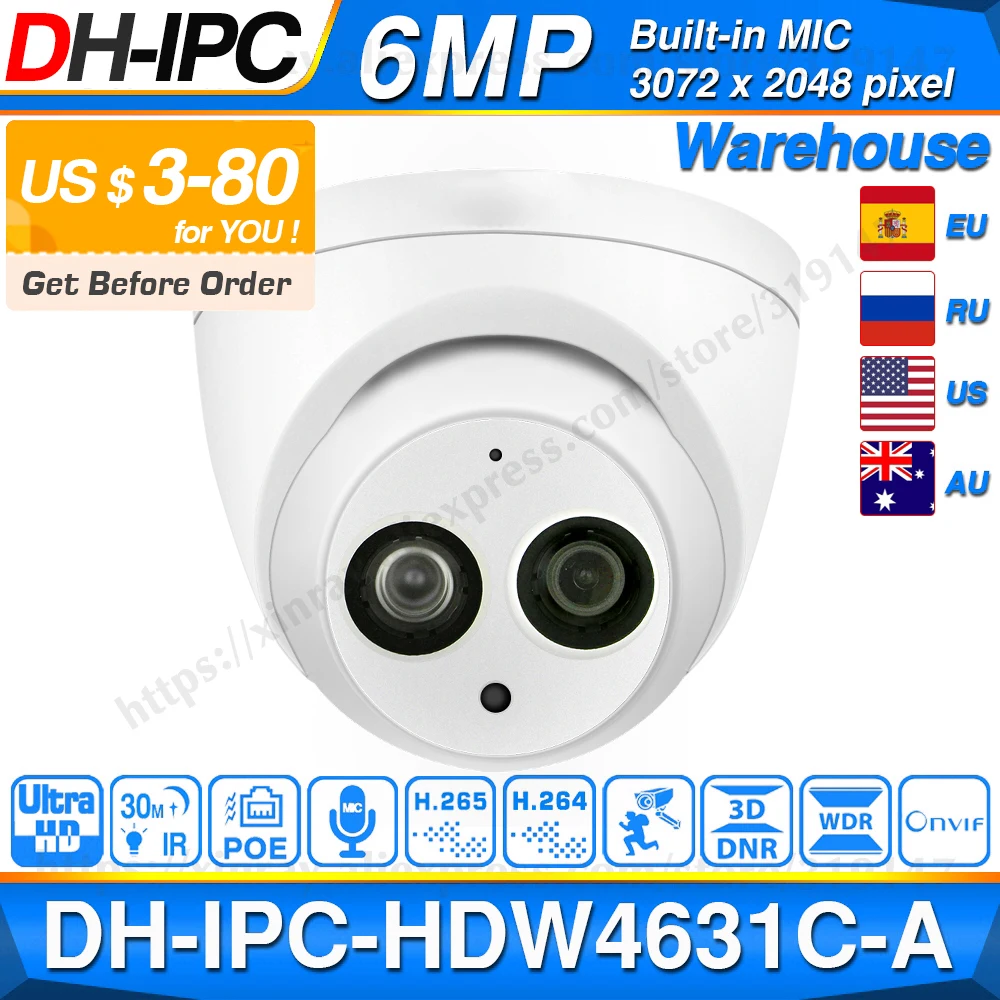

So i am thinking about adding the following camera and was wondering if this one will be a good option
What do you all think ?

Well not yet however the people I spoke here got great experiences with dahua and hikvision as they also have the app available. I found a nice deal on Ali Express by ordering trough a warehouse in Spain to avoid high customs charges so I will be spending around 50€ for 1 camera. I think I am going to order one just to see how it works and if its what I think it is I will need 4 more :slight_smile:
Yeah, I’m also leaning towards that. Which camera model are you looking at more specifically?
#Aliexpress € 49,89 33%OFF | Dahua IPC-HDW4631C-A 6MP HD POE Network Mini Dome IP Camera Metal Case Built-in MIC CCTV Camera 30M IR Dahua IK10 HDW4631C-A
I saw this one

Yeah finally I chose for Dahua but to be honest I think you can also use other cameras that are cheaper and use the onvif protocol. However to be honest the connection between camera and homey is nice but maybe a bit overrated.
As forwarding screenshot is something that the camera has as standard option. The Dahua Lite product line using the DMSS app will not offer casting to a Google hub or other. However the Dahua Imou line does offer this but both have huge differences in quality.
So yeah it’s nice the possibility but to be honest I expected a bit more. It’s even so that I am now checking to buy a raspberry pi and install Hassio or Domoticz to see if this has any extra value.
