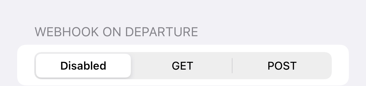

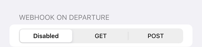

Update: it only registers when I arrive, not when I leave. It looked so easy…
When it registers arrival and not departure then most likely u did not fill in the get request for departure.

If you click and hold your location in the Locative app, you can trigger an event. So this means my webhooks work just fine.
If webhooks work just fine there must be an error in the flows.
Flows work fine. It’s just the Locative app which does not update my location and trigger the webhook.
