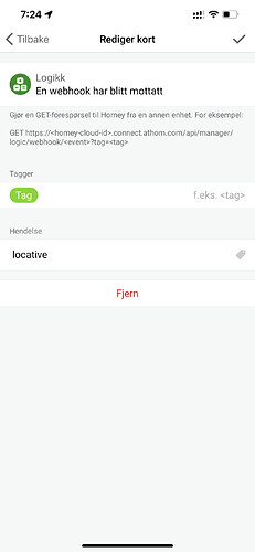

Why doesn’t this flow work? And why is the flow grey (not active) tested flow it work tested url in locative ok hmmmm :thinking:
https://homey.app/f/DzXJJM![image|231x500](upload://4QkH6Z9rBSua1b2yKd0dpa0gJBq.jpeg)
Flow is grey because there is a need for some logic tags. It’s normal.

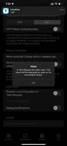

And what does the url look like in Locative ?
logic/webhook/locative?tag=julusmoenhjem ?

“Locative” in flow vs “locative” in url
Changed big letter to small letter in logic to small l​:+1::laughing:where in the url is locative shown?
https://Xxxxxxxxxxxxxx.connect.athom.com/api/manager/logic/webhook/event?tag=julusmoenhjem
In ur flow u check for “Locative” and in the url u make it “event” .
U have to make up ur mind and choose 1 of them in both.

Still same mistake as yesterday.
Url should be
https://mycloudid.connect.athom.com/api/manager/logic/webhook/locative?tag=julusmoenhjem
After the webhook/ part comes the name of the event.
In my case the event name is “locative”.
In ur flows u check for the event name, locative in this case. But in the url u name the event “event”.
So that’s not good.

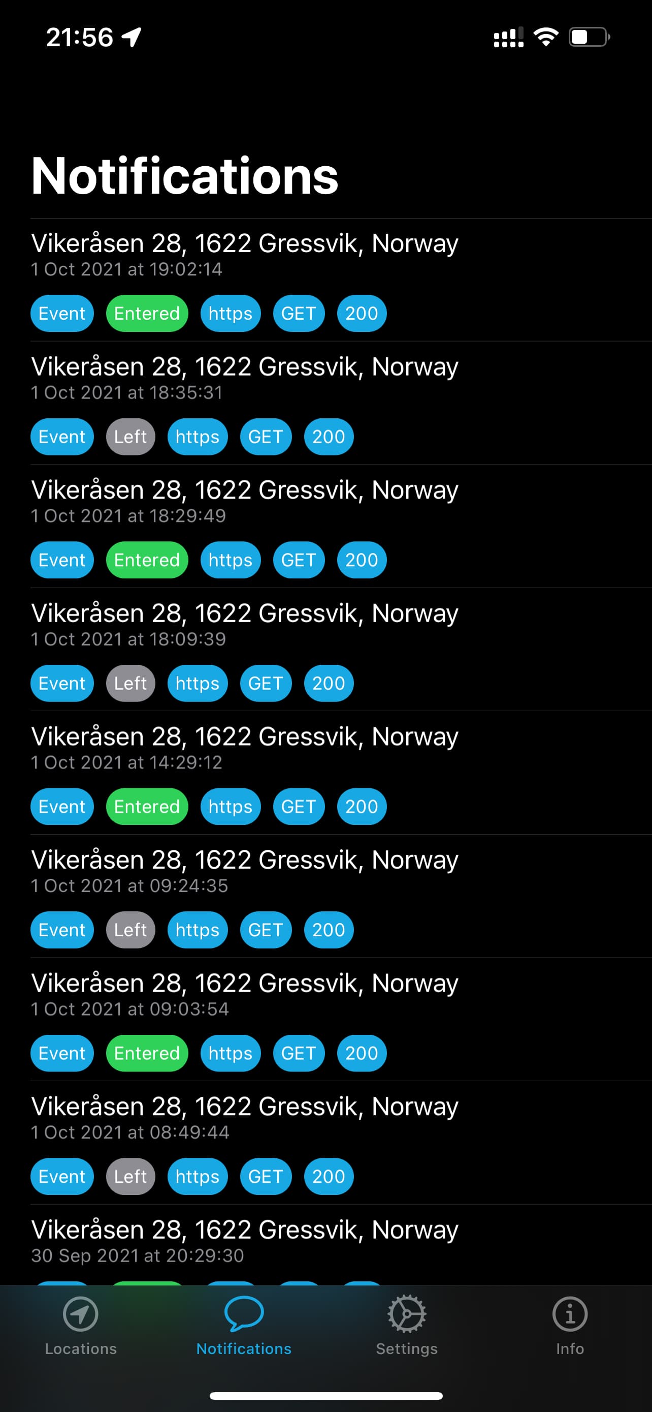

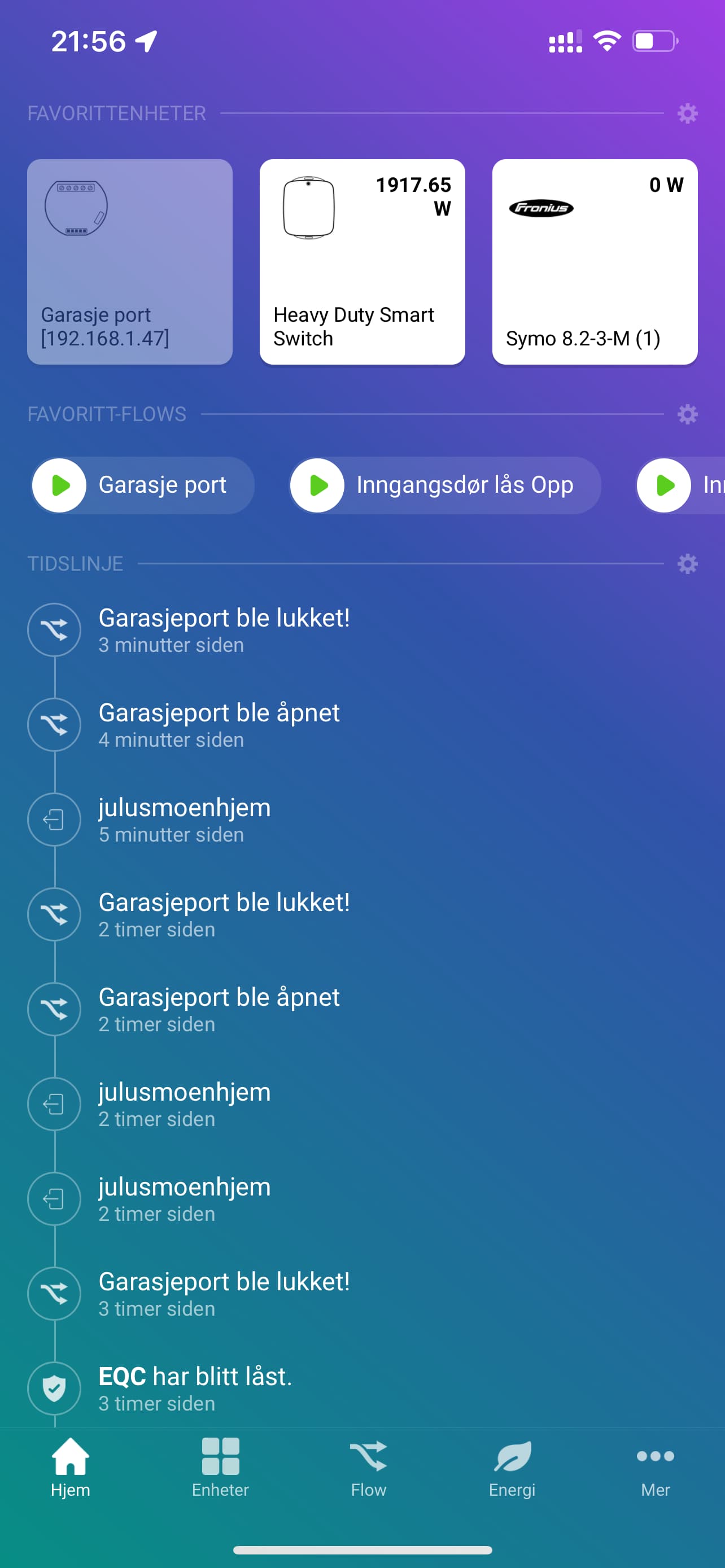

One thing is wrong… suddenly when om watching tv the Homey says the garadoor open​:flushed: julusmoenhome? Why? Now the clock is 22:00 the flow started to run… Without me moving?:thinking:

Only thing I have changed is the meter of way from home 100 m to 550 m and webhook for my wife. When I test it in locative it runs the flow.
Then maybe try to set the range to 400 and try again?
If that’s the only thing u have changed then maybe play with the range a bit.
