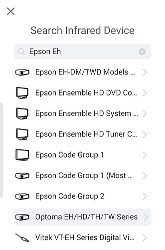

I got one device which uses IR only (epson eh-tw7100) and I can’t seem to find a proper IR driver for it.
Just wondering then if there is a list of all supported devices somewhere and if there’s a place to ask dor a new product?

When you start connecting an IR device, to find your device, start typing the devices name/brance, then a list of supported devices will be shown.
For new products to be added, contact Athom service.
You can try several remotes without installing. It’s worth a try.
There’s often no need to match an exact model or type.
