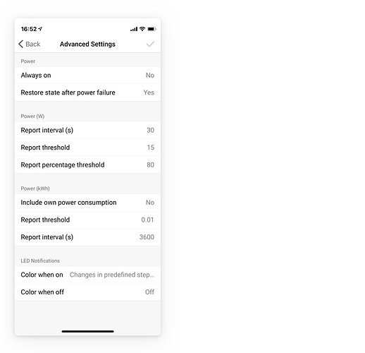

What does it look like on photo 1 or 2 when you create via HTML page?
PHOTO 1 :
PHOTO 2 :
The first scrennshot are device settings => default generated screen.
The other screenshots are app settings => html where you can define imput fields and store the values in app settings. You can extend the html page with further information.
The device settings are generated by your driver.compose.json in the settings-array (homey.gruenbeck/driver.compose.json at master · RonnyWinkler/homey.gruenbeck · GitHub).
The app settings page is defined in /settings/index.html
I do need the option to use images in the device settings and not in the app settings.
Is there also a possibility for this?
How to do this, Code example?
I don’t know much more than listed in the developer documentation (see link in my last post).
As I could see there, html is not possible in device options.
No.
