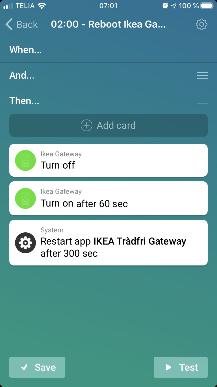

I thought I was the only one. Using a smart plug now to do this once in a while, of course not an Ikea type :smirk:
Done! Set up a flow that cuts the power for my Ikea Gateway every Sunday for 60 seconds. :+1:t2:
Don’t forget to restart the Ikea gateway app also afterwards!
