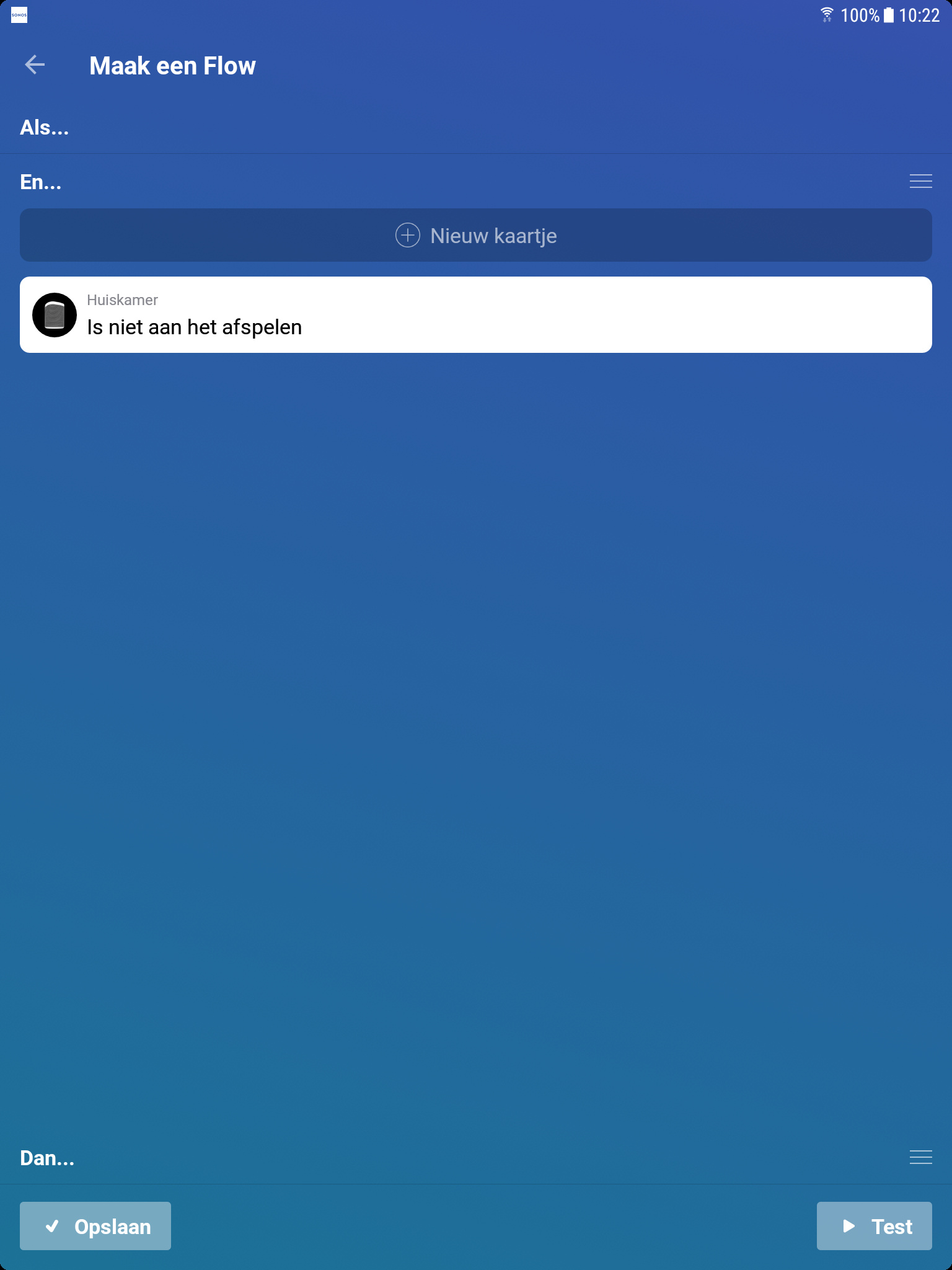

Screenshot_20190709-102208

I also want to be able to check if a specific Sonos device or group starts or stops playing in the flow:When section.
In Homey version 4.0.0. this is still not available. Today I have filed a feature request at Athom.
I will post an update as soon as I have received a reply from Athom.
I was wanting something similar, basically I have a virtual button which allows me to start a flow for Alexa. Problem was, as you can’t check on play/pause the button would get out of sync if the Sonos is started via App or on a timer etc.
What I did was setup a timer, so every 1 minutes I check IF the Sonos if playing, then I turn on the button, else I turn off. Works well, as long as you aren’t concerned about the small delay. I expect you could do it every second, but not sure how that would affect then Homey.
Just need to check that the flow for starting the Sonos also checks, otherwise it constantly restarts the playlist.
