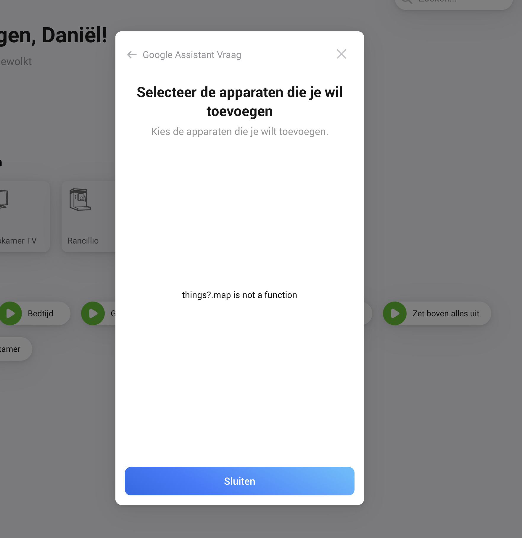

Hi @RonnyW,
I get an popup, but i get this response:
When i copy the response from google from the console, i get this html:

You defined the redirect URL in your MyBrandOAuth2Client.ts. Looks ok.
But your driver raises an execption fot “things”. The “things” function is only an example where you can call your API.
I’m not sure what you are doing here: nl.danielvanbreda.gaquery/drivers/google-assistant-driver/driver.ts at main · thadrax/nl.danielvanbreda.gaquery · GitHub
This list devices function is calles after oAuth process (oAuth is valid and you got your token) to read available devices you can add to Homey. I don’t know what “devices” you have for this API.
You oAuthClient redefinition should provide functions to read the API. The oAuthClient has access to the token etc.
Example: homey.tesla/lib/TeslaOAuth2Client.js at main · RonnyWinkler/homey.tesla · GitHub
In your driver, just call the method of your oAuthClient like this: homey.tesla/drivers/car/driver.js at main · RonnyWinkler/homey.tesla · GitHub
