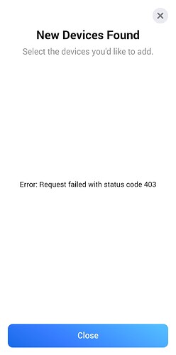

Hi, I have a problem with the Hunter Hydrawise app in Homey.
I have an irrigation system from Hunter installed, I generated an API key, which I then entered in the settings of the Homey app, but when I try to add the irrigation system to Homey, âRequest failed with status code 403â pops up.
Can someone advise.
Thanks
Did you manage to get it working? I just installed mine and got the same error. After finding your post I realized I needed an APi key and after adding that everything workds fine. I also marked the checkbox status updates.
403 means âforbidden to use server Xâ, so probably something isnât right on authentication level.
You can check the key for a changed first character (the result of auto-capital functionality), and for hidden whitespaces.
I had some empty Controller in the app. After deleting it is working now.
