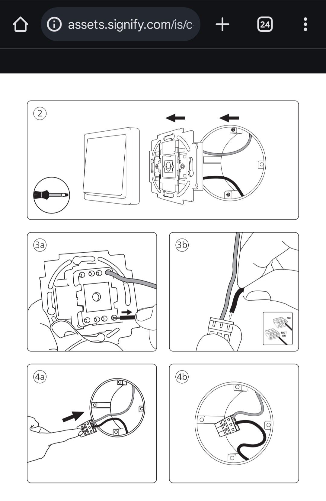

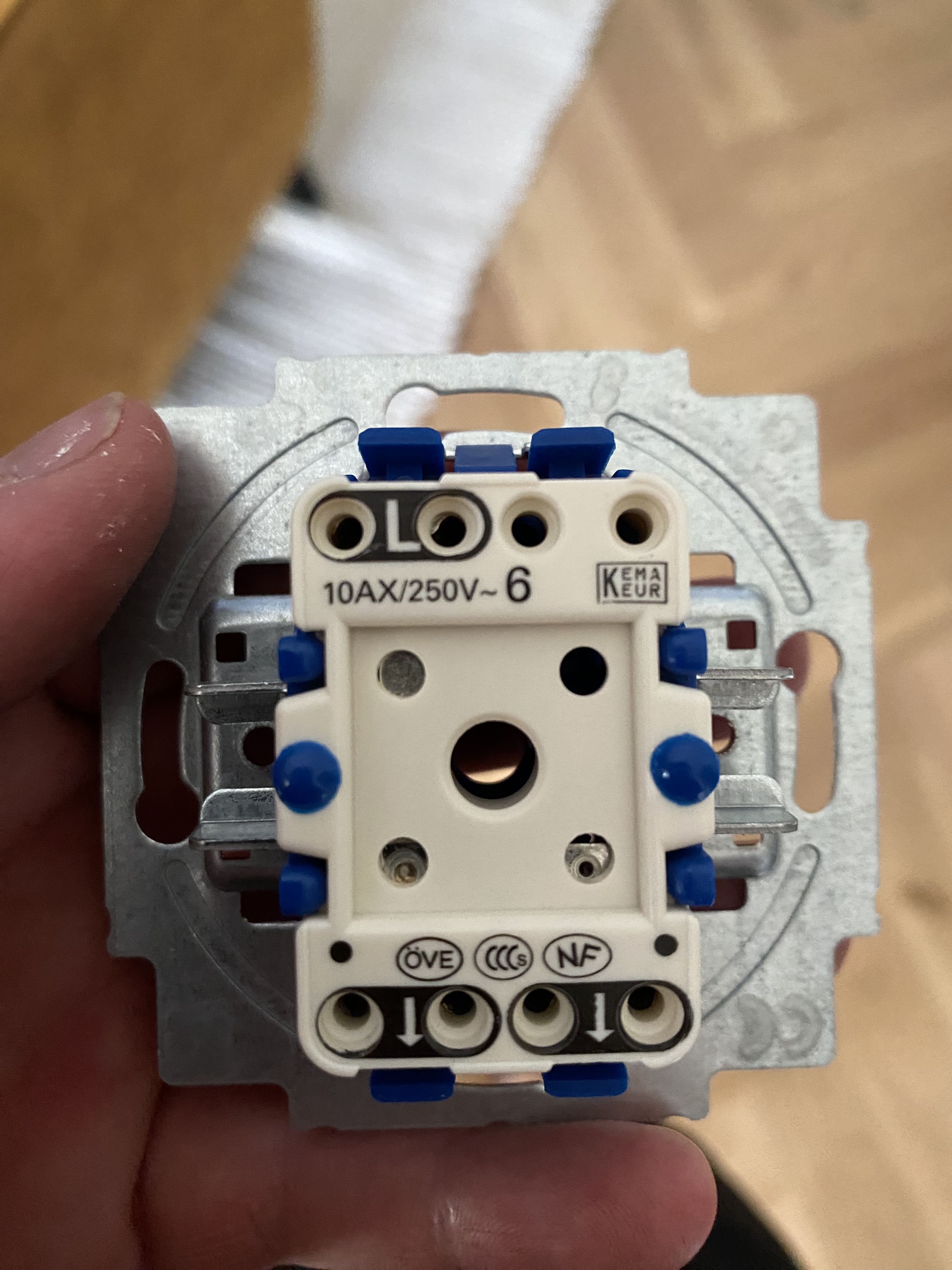

Hey guys, i was wondering. I think it does not work they way i would like, and i dont want to blow up a switch to try it, but i have the folowing.
I installed the hue wall switch on a single button, however i have another button within this wall, that has a dumb bulb on it. Can someone verify it is NOT possible to make the dumb ceiling light go on, and NOT to fry the hue switch?
