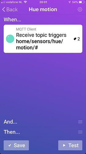

The mqtt output node points to your MQTT broker. If you installed a broker on your Homey device then the ip-address of your Homey with your configured credentials. An external broker would also work in this case.
Now create a flow and add the MQTT Client card and set the topic to the topic variable created in node-red: home/sensors/hue/motion/true or use a wildcard home/sensors/hue/motion/#
The rest is up to you.

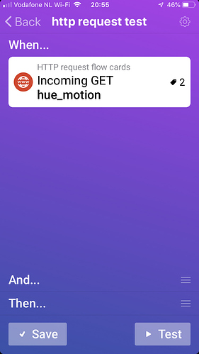

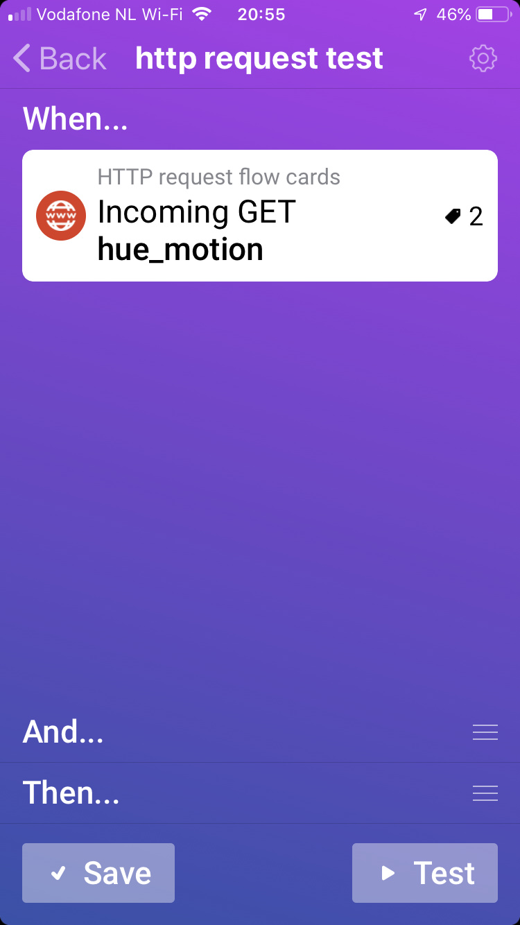

another option could be using a HTTP request flow card
For this option to work you will have to uncheck the require authorizaton on api setting of the HTTP request flow card. While you could add headers to the call from node-red this is out of the scope of this simple example.
Make sure the ip-address of node-red is whitelisted.
Just as the previous example. First you need to parse the Hue motion node in a function block. The ip-address is your Homey ip-address.
var newmsg = {};
newmsg.url = '192.168.1.61/api/app/com.internet/whitelist/hue_motion/'+ msg.payload.motion;
node.status({text: 'url: ' +  newmsg.url});
return newmsg;
Next add a http request node. No need to set anything. The url is passed from the javascript function block to the http request node.
Now go to Homey and create a flow and add a HTTP request flow card and set the event name to hue_motion.
Just as before you can now complete the flow by using the value tag containing either true or false.
