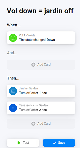

Flow OFF command never worked, i tried multiple flows, the lamp never goes off

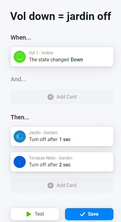

in this second flow, “jardin” goes off, but not the "terrasse philips hue bulb
I tried since a few weeks now but i cant find a solution
Could you help me out?

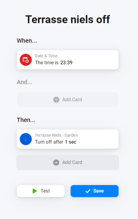

I read in an other thread, that there should be a problem with time triggers. But I don’t know if it’s true.
But I know that there is an issue with the Homey Web App when using Safari browser and you want to add a time trigger. My suggestion is to make a new „Off“ flow by using the Homey smartphone app.
Right. I also assume that it is not a problem with the Zigbee frequency.
I’ll try that, on app!
Note that the first trigger isnt a time one
Oh Thanks for your suggestion, Peter, and your time, but this and that, so I think the problem lies somewhere else. Have a nice day.
I can confirm one thing
deleting all my existing flows and recreating them only from the mobile phone, does improve teh satbility of the flows
The is indeed a problem that tome triggers before 12:00 require two digits for the hour, and not all versions of the flow editor seem to put that in. so 07:00 should trigger fine, but 7:00 does not.
