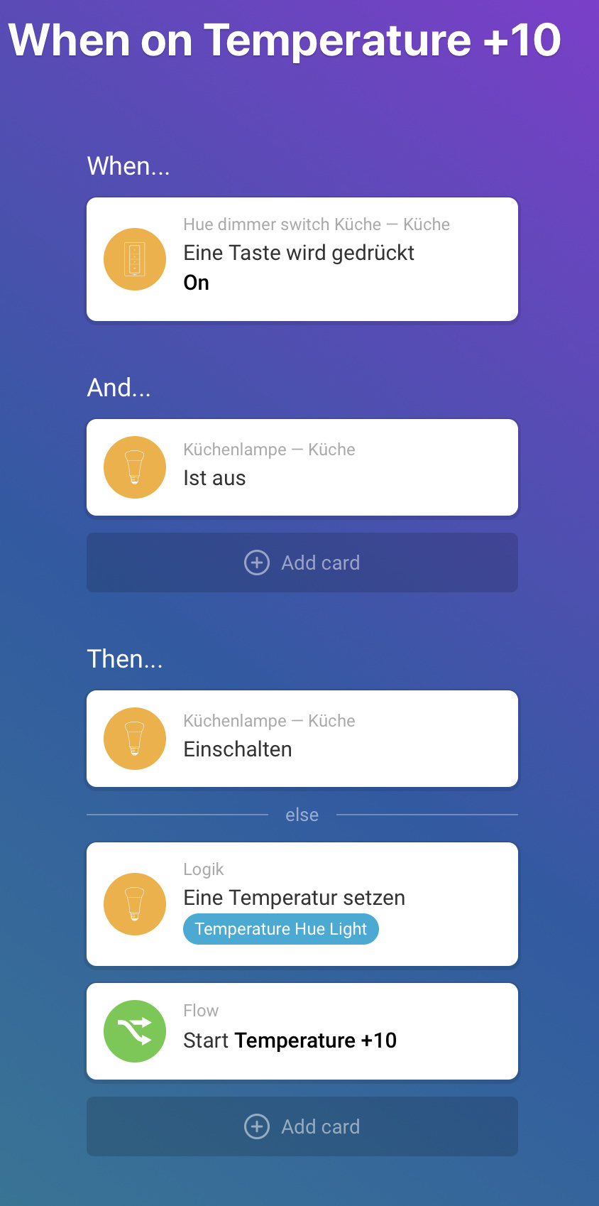

You need a variable plus 2 flows
Create a variable e.g “Temperature Hue Light” default value = 0
First flow
Flow Temperature +10
When flow is started
And Variable “Temperature Hue Light” <1
Then Temperature Hue Light = Temperature Hue Light + 0.1
Else Temperature Hue Light = 0
Second flow
When on Temperature +10
When Hue Dimmer pressed On
And Light is off
Then switch Light on
Else set Temperature Light = Variable “Temperature Hue Light”
and
start Flow “Temperature +10”
If the light is off, it will be turn on.
If its already on you can change the light temperature in 10 step.

Cards are correct but did u first create the number variable in the “normal” logic settings like @Osorkon explained?
Then , at the questionmark in ur example from the first card, u can choose that variable u just made.
At the txt box u fill in {{taghere+0.1}}
Please do not use spaces here!
