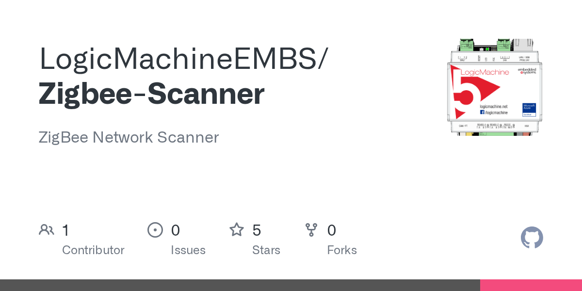

No, 15 and 25 are far away. If you have a PC and an ESP32C6, you can install this sketch for analysis of nearby ZigBee networks/interference. It has helped me discover my ZigBee issues

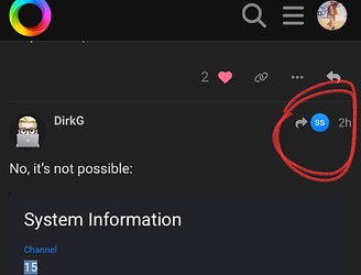

No, it’s not possible:

FWIW: here you can view to whom someone replied, & you can tap on it to see the post
