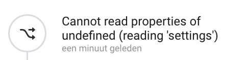

I log my water / gas / electricity data from my smartmeter via Domoticz. This data is also used in Homey; I use the http request App. This has worked flawlessly for months, till this morning…
I get the error:

What could be wrong??
My guess is an issue with Better Logic.
Man, you are fast!
I removed the BL variables in the flow card and added it again. Now it works!
