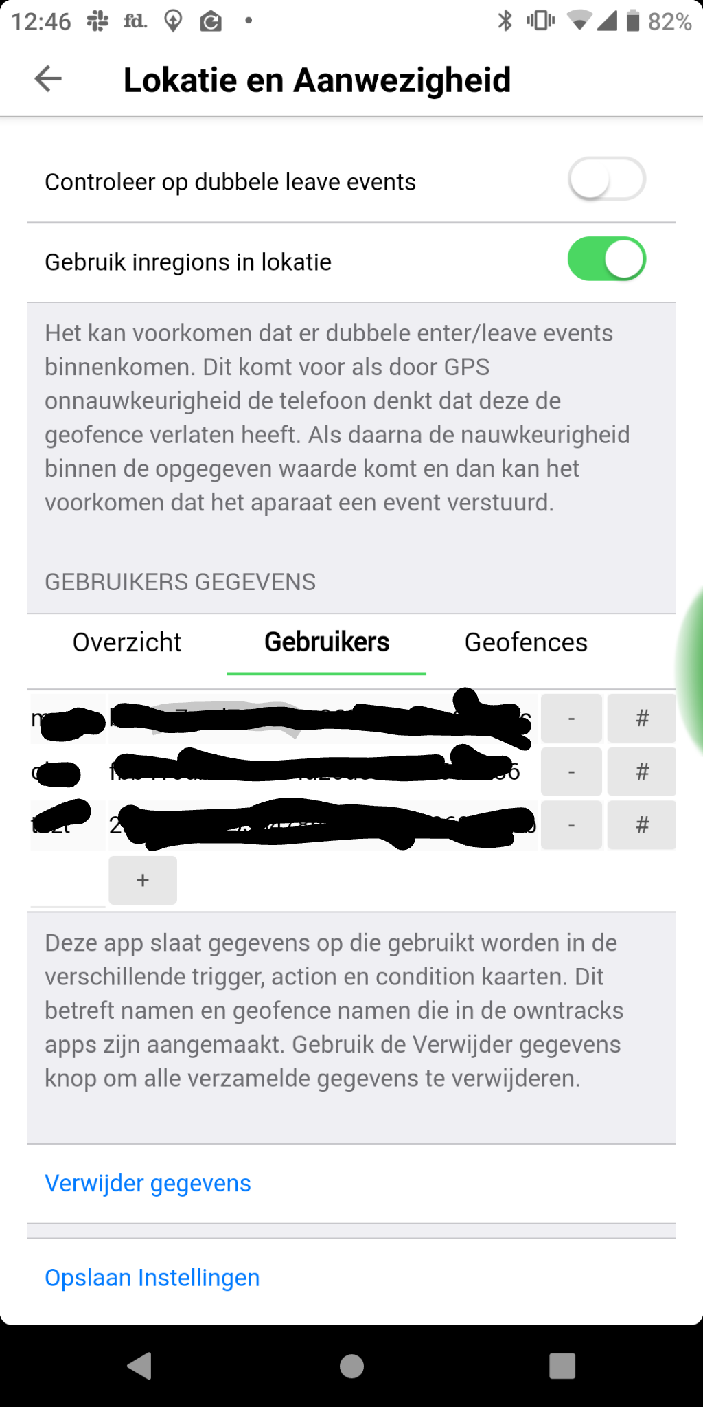

As nothing seems to work so far as a location tool i want to try if Owntracks works. Starting with HTTP connection first as i want to see first if it works. MQTT will be an option for later if i can figure out how that works. I have installed the app on homey and on 2 phones. Both huawei mate 20 pro’s. Android 9.0.
Homey had 3.1 installed. I made 1 region called “thuis”. so far so good. I don’t. See the correct settings in the homey app
the fence data is not updating! What am i doing wrong. Already been out today several times so thats not the case.still not updating . Tried to set inregions in location. No change
this is what the log tells me
I have tried restarting homey, no luck. remote commands is on, inaccurate locations is set to 50.
i am out of options to try, can anyone tell me what i am doing wrong?
