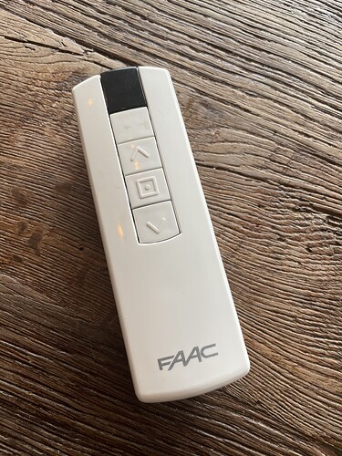

Can you post a picture of the remote? Some of them use rolling codes.
Yes, i took the one you said!
I will send a picture later today! Tanks for your help so far :slightly_smiling_face:
This is my remote! It sais 1 channel remote
I have allready find the manual for this remote and it sais that its a rolling code! So this will not work then! Thanks for your input and time!
