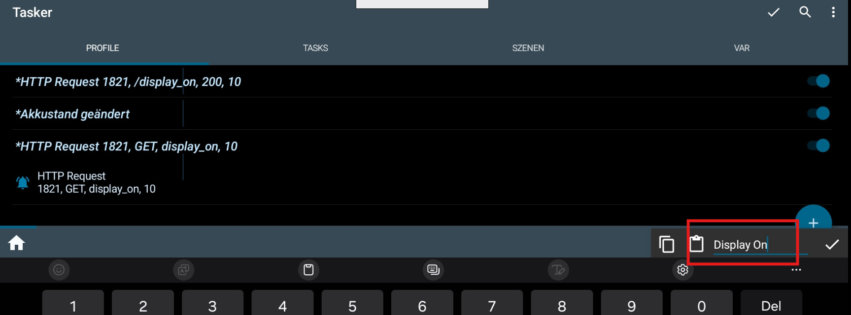

STEP 1: Add a profile:
Create a profile and select “Event” as trigger.
Select “Network” category and “HTTP request” event.
The port ist already set, but you can change it.
Select the GET method and set a URL path you want to use.
STEP 2: Add a task:
Go back when ready. Tasker asks you to create a task for your new trigger. Give it a name.
Now your are already inside your task. Create an action.
Select the “Display” category and the “Turn on” action.

Is the trigger turned on in Tasker (the toggle at the right side in profile page)?
Yes, unfortunately it’s not that simple somehow. i also checked the app. permission in android… but no effect.also changed the port (1822) but still ERR_CONNECTION_REFUSED or HTTP ERROR 503

Can you execute the action (turn display on) from Tasker itself? Perhaps a system permission (display access) is not set for Tasker app.
i made a task that when there is “any sensor motion_detect” the screen goes ON, and that worked. So i think im gonna keep that task :slight_smile: thnx again for your help!
