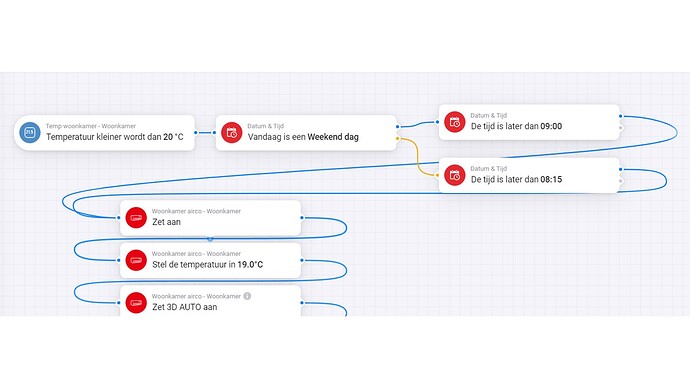

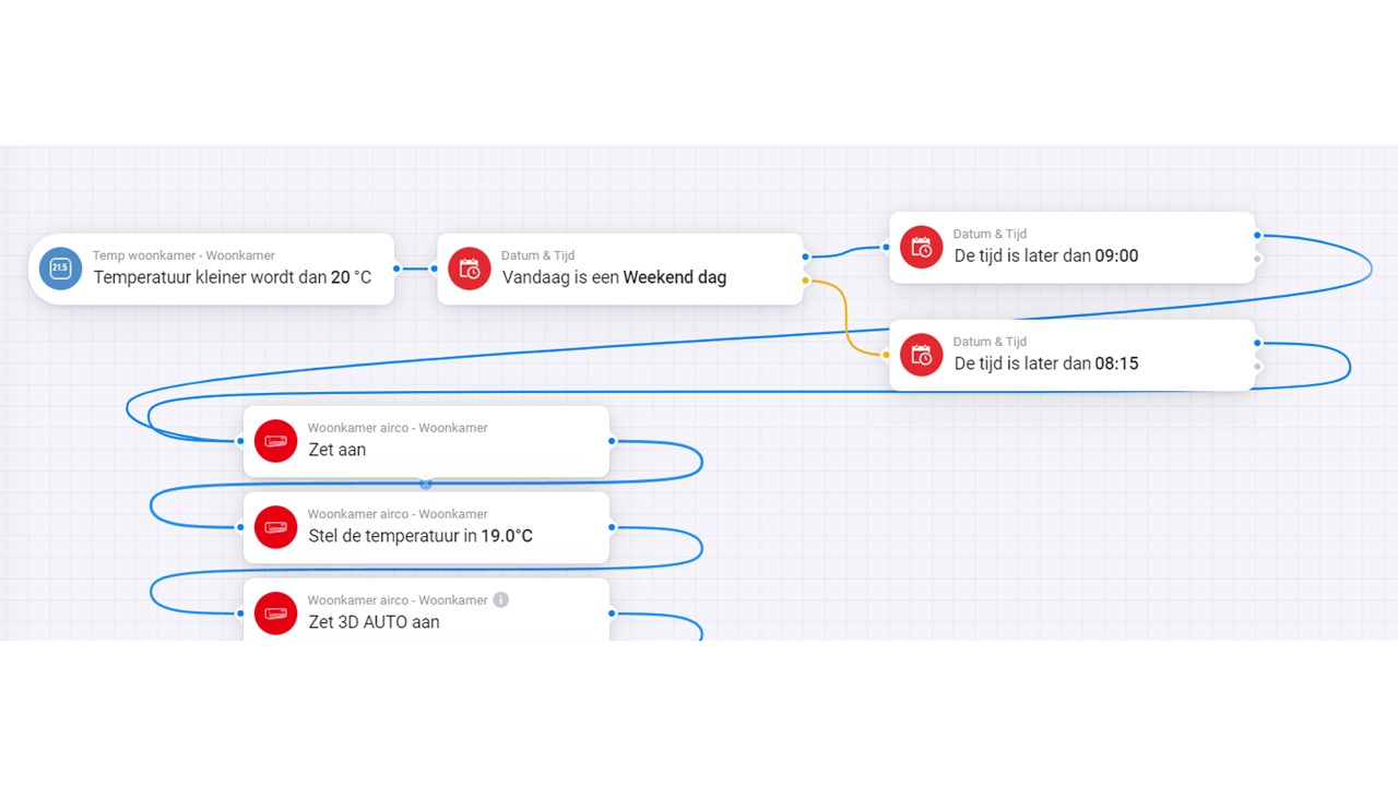

I have this flow, but it will not start at the beginning of the day.
What do I do wrongly??
Is the temperature already lower then nothing wil be happening.

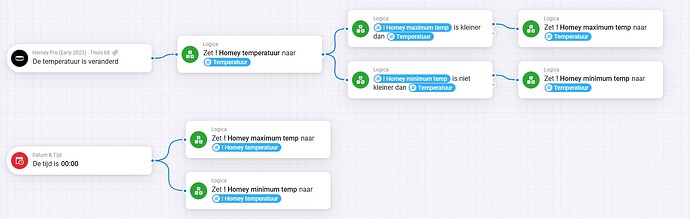

If you used a variable to notice that the temp. is <20°C you can test it then on the giving day and time.
Needed more time for looking for an example and make it ready for here
The minimum and maximum temp. you can skip of cores
Thanks. I will try this
