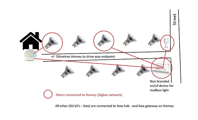

Strange thing is the (automatic) created routing table, is shown below in the graphical overview. The Homey connects directly to the non branded Zigbee device about 50 metres away. My expectation what that the hops between were neccessary to reach the far end. But the opposite happened, the device 50 metres way is selected as accespoint for the devices closer by the house. (except the GU10 that is 2 metres from the Homey)

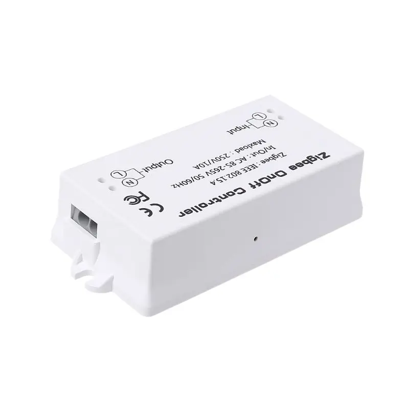

Maybe it’s interesting to know that this device looks quite powerfull in range, and so allows the user to expand the Homey nework in an easy (and cheap, approx 8 euro) way. (name of product on aliexpress; Zigbee Op/Off Controller Smart Switch App Afstandsbediening Smart Home Module AC85-265V 10A)
This one?
https://www.aliexpress.com/item/10000209855754.html?spm=a2g0o.productlist.0.0.63d35ff51vEVxq&algo_pvid=1221194a-0d69-4d91-9c85-d7bc29bac445&algo_expid=1221194a-0d69-4d91-9c85-d7bc29bac445-4&btsid=0b0a556f16055540403991175e956e&ws_ab_test=searchweb0_0,searchweb201602_,searchweb201603_
Or this one?
https://www.aliexpress.com/item/32871275991.html?spm=a2g0o.productlist.0.0.1846438edespVu&algo_pvid=a37ad9cd-7cd5-49f9-baa8-875e7b4763e2&algo_expid=a37ad9cd-7cd5-49f9-baa8-875e7b4763e2-1&btsid=0b0a556116055541357665666e11ce&ws_ab_test=searchweb0_0,searchweb201602_,searchweb201603_
Homey’s overview of its Zigbee network isn’t complete. It could very well be that the non-branded device has both a direct connection and a connection through the GU10('s). Homey only shows a single route, where multiple can exist.
Interesting, learned something. I made my conslusion based on below;
Maybe strange question, but what’s the value of the routing table if it doesn’t show complete information (with what you could investigate issues, if they appear). I also assume that if the table shows that specific path, that’s the first choice, the strongest, or the one it’s using. I’m just trying to learn how the interpret the available information and optimize my implementation based on what I can see or analyze. (Like trying to eliminate the roughly 10 seconds delay between motion and increase of brightness.)
I didn’t included a link for the situation the advertisement is removed or another supplier is offering the same device.
I bought the following device, ad is currently still valid:
Node 17 could just as well have a direct connection to Homey and to node 18. I have no idea how Athom decides which route to show. There isn’t necessarily a “strongest” or “the one being used”, that’s all very dynamic within Zigbee.
