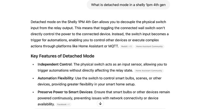

So, if I underarqnd you correctly, a shelly product (like a shelly 1pm 4th gen) in detached mode would accomplish that, right?
Yes, how ever I have no experience with Shelly and don’t know how to set detached mode in Homey. Just search for “Shelly detached” or ask in the appropriate categorie. However you asked for a Z-wave device.
