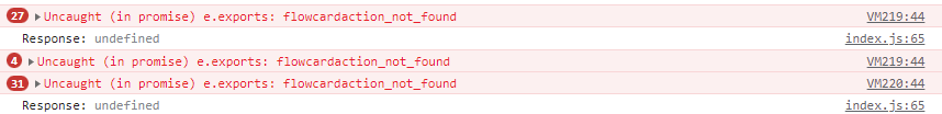

Strange…today I was fixing another flows for another devices (I (re)moved some of my Zigbee routers ;-))) )…it worked…then I came back to the device I originally tried to fix - again soft run is OK, but real run - getting errors :
obrazek
Is the /flow/flow part right ?
await Homey.flow.updateFlow({ id: f.id, flow: { id: f.id, actions: actions } });
The script runs fine when commeting out actions part for updating actions cards…???
I will probably fix it manually but still I find it interesting.

Martijn I know what is different when it doesn’t work. I’m actually trying to fix same device BUT from different app ! It’s for sure the reason, do you think that this could be somehow adjusted for such cases ? Might be VERY useful mainly when some devs have abandoned their apps and are even not willing to transfer - it means new app is available then but as you know, with completely different ID…so even the device type, flows, triggers etc. are the same, script doesn’t work.
Btw I will try also based on name script, if that will not resolve the issue…
udpate so nope, even based on name it do not work.
