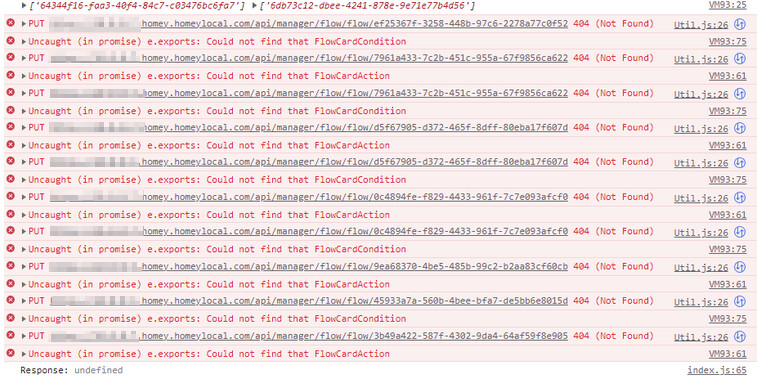

Hm, because I didn’t understand what you mean exactly, I tried that anyway :wink:
So in this case, it’s about Roborock app (abanoned) and Xiaomi Mi Home app (full rewrite) - and I was able to transfer/migrate my flows.
With previous app disabled :
With previous app enabled and still working :
And it somehow corresponds, I still have two flows not migrated - example OLD and NEW one :
So partial success :wink:
I’ll have a look if I can update this somehow :stuck_out_tongue:

This is the console output.
There is no response coming at all, like when it does when for example running:
Homey.users.getUserMe();
type or paVM28:33 Uncaught (in promise) TypeError: Cannot read properties of undefined (reading 'replace')

eval @ VM28:85
(anonymous) @ index.js:62
Promise.then (async)
(anonymous) @ index.js:60
PageToolsAPIPlayground.handleRun @ index.js:59
Ve @ react-dom.production.min.js:52
Xe @ react-dom.production.min.js:52
(anonymous) @ react-dom.production.min.js:53
jr @ react-dom.production.min.js:100
Ar @ react-dom.production.min.js:101
(anonymous) @ react-dom.production.min.js:113
De @ react-dom.production.min.js:292
(anonymous) @ react-dom.production.min.js:50
Nr @ react-dom.production.min.js:105
Qt @ react-dom.production.min.js:75
Jt @ react-dom.production.min.js:74
t.unstable_runWithPriority @ scheduler.production.min.js:18
Go @ react-dom.production.min.js:122
Ie @ react-dom.production.min.js:292
Kt @ react-dom.production.min.js:73
4VM28:33 Uncaught (in promise) TypeError: Cannot read properties of undefined (reading 'replace')
    at eval (eval at <anonymous> (index.js:62:18), <anonymous>:33:41)
    at Array.forEach (<anonymous>)
    at eval (eval at <anonymous> (index.js:62:18), <anonymous>:32:19)
    at main (eval at <anonymous> (index.js:62:18), <anonymous>:12:26)
    at async Promise.all (index 0)
eval @ VM28:33
eval @ VM28:32
main @ VM28:12
await in main (async)
eval @ VM28:85
VM28:47 Uncaught (in promise) TypeError: Cannot read properties of undefined (reading 'replace')
    at eval (eval at <anonymous> (index.js:62:18), <anonymous>:47:44)
    at eval (eval at <anonymous> (index.js:62:18), <anonymous>:46:22)
eval @ VM28:47
eval @ VM28:46
main @ VM28:12
eval @ VM28:85
5VM28:33 Uncaught (in promise) TypeError: Cannot read properties of undefined (reading 'replace')
eval @ VM28:33
eval @ VM28:32
main @ VM28:12
eval @ VM28:85
eval @ VM28:47
eval @ VM28:46
main @ VM28:12
eval @ VM28:85
eval @ VM28:33
eval @ VM28:32
main @ VM28:12
eval @ VM28:85
    at Array.forEach (<anonymous>)ste code here
That doesn’t look healthy at all…but those are details already when expanded, or ?
no, can be expanded to a lot more…
I’ll have a look later @Stanley_Oei
Thanks. For now I manually updated the flows… But still nice to know what went wrong / what I did wrong.
@martijnpoppen i have the same problem, when I want to repair a device (Xiaomi switch mini) everything seems to work. and as you can see, in the device setup the flows are coming back. but it doesn’t repair them on homey 2023
@Robin_De_Lange maybe its already using the new webapi. Will check!
Hi @martijnpoppen ,
indeed seems it’s not compatible anymore with HP2023 ;-( I guess there isn’t “easy” fix, right ?
@Sharkys there will be,
Your last image just shows what i need :smiley:
Will update!
Edit: probably i’ll post 2 scripts, one for legacy and one for HP23
Oou… so no need to rewrite like 100 flows ? :wink: THANK YOUUUUU !
No its that the webapi for Homey 2023 is updated and uri is removed. So have to do some checks, shouldnt be that hard.
Will probably have a fix tomorrow :slight_smile:
@Sharkys new script is ready (also added to top post): https://gist.githubusercontent.com/martijnpoppen/dcf0b8fd3f7fe63dec087c87dbc66090/raw/c15ede06bb4a26b6b06536e9751cfc7c0a89320a/gistfile2.txt
Next to that added variable support for advanced flows. I saw I didn’t include that earlier :stuck_out_tongue:
I would recommend softRun first :smiley:
The script should work for both Homeys now
You said tomorrow ! ;-)) Checking, testing… thank you !
