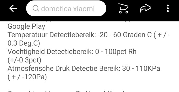

Regarding your suggestion: Is it capable to measure temperatures of 90 degrees and above? If I read the specs it isn’t. I used the Fibaro multi sensor and it melted (mainly the plastic) :-(. So I need a temp-device that can measure up to 100 Degrees and above (to be sure).

The Aqara can handle 100% humidity, so that has to go right.
But, the temp range is -20 - +60°C. Inside a sauna it can get hotter than that. I don’t think it breaks down at 90°C, but the measured temp stops being updated at 60°C.
