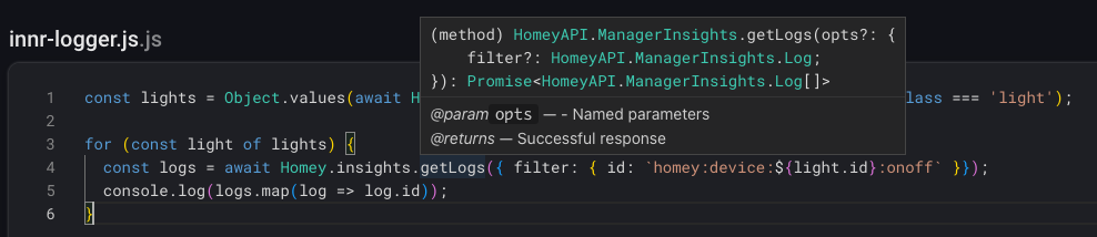

I did use the IntelliSense Feature of the Web-Editor for HomeyScript. It shows that I can use options for a filter:
This seems to mismatch what the linked Web API documentation says (which is without any options). Which one is the source of truth and do you know why IntelliSense shows these function parameters?

I don’t know why the IntelliSense popup is mismatching the documentation, perhaps @Jero can explain?

This is kind of bad that we still did not update HomeyScript but other things had priority.
HomeyScript uses the old npm library and the docs are for the new one.
The types though are for the old one.
I know its a mess.
