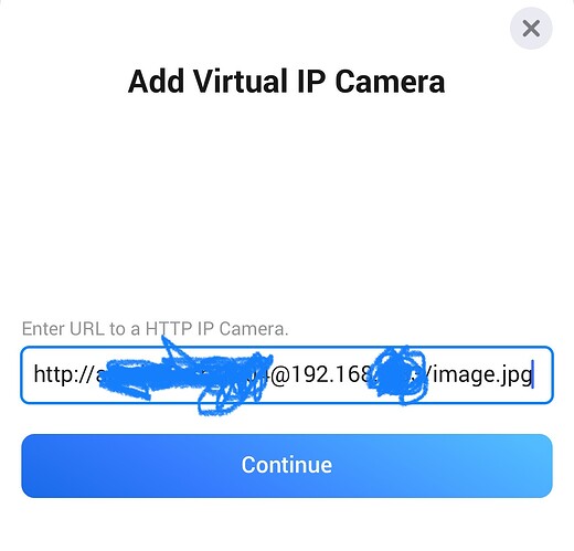

This is what I did:
Homey is asking this:
This is what I filled in:
This is the error:
What can I do more then filled in what homey is asking for?
Regards
The http://user:pass@192.168.1.10/image.jpg text is purely a placeholder (an example).
You already said that when opening the URL http://user:pass@ipadress/ISAPI/streaming/channels/101/picture in a browser, you get an image, so that’s the URL that you should be using. But that URL gives the same error (the one with randnum in it)?
