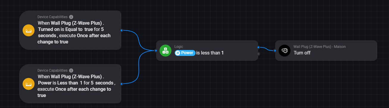

I came to this solution, tested with a lamp connected to the Fibaro plug with such a cable
It works like a charm (Well, as long as the flow is not broken in the middle with the plug on but no consumption - i.e.: lower than 1W).
THX A LOT again for pointing and these Advanced Capabilities !
V.
I’m pleased that you found a manual solution.
I think I have understood your use case now and you don’t need no extra cable. Try this flow:
