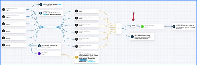

I have an advanced flow for my central extraction. If all switches or data Co2 switch off their respective virtual switch, then the extraction will only return to position 1 after 5 minutes.
And with those 5 minutes I think I have a problem. It seems like everything is off on e.g. the lighting of the toilet and I turn it off, I now get to check that the extraction goes off after 5 minutes. the timer is then counting down. If I now turn on the lighting in the shower within 5 minutes, my extraction will go off after those 5 minutes. is there anything i can do about that?
