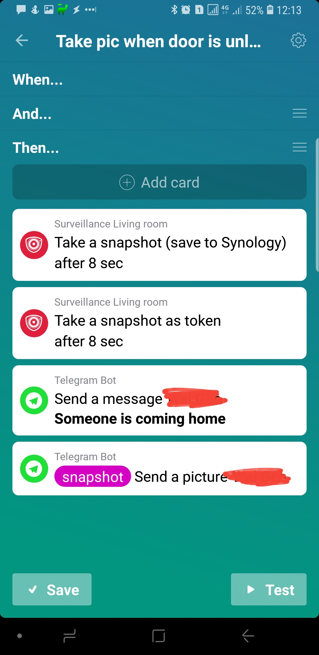

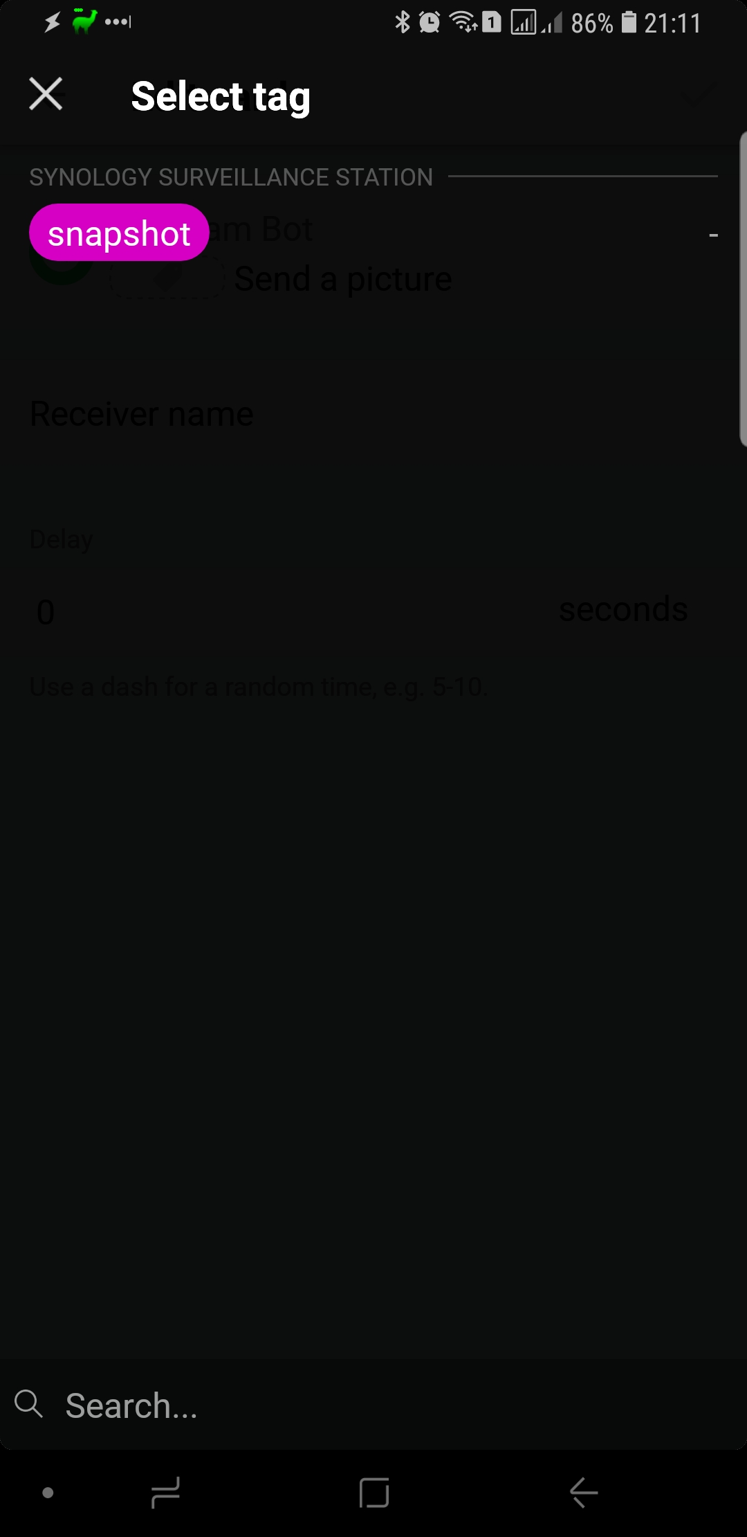

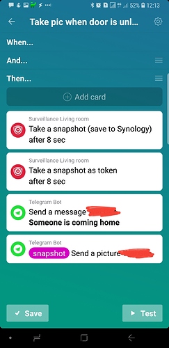

Would you be able to kindly explain what you mean by “local” vs homey’s search? When I select the send a picture card and tap the ? icon, the only option available to me is “snapshot” under the synology app.
Screenshot_20190305-211101_Homey
What do you use as a trigger (in the when…)?
The trigger is linked to my Yale digital lock when it opens.
The picture isn’t taken when the locks opens. You should do it like:
  1. when lock opens then take picture
  2. when picture taken then send message
then you can use the local tag for flow 2. Now it’s taking the last picture (if it does take one at all).
The picture is taken not in the “when” portion but in the “then” portion.
Note that I incorporated a delay of 10 seconds before sending the snapshot. It is not reflected in the screen cap as I created the flow for illustration purposes only. (I deleted the card as it kept crashing)
  • Please note that Synology, the webcam AND the Homey app might have problems if you save it as a token and save to synology at the same time.
  • Don’t send it to Telegram this way, add a second flow which triggers on your Surveillance Living room device with “a snapshot was taken”. Then you can do that without a delay, because it was trigger the flow when the snapshot is done.
