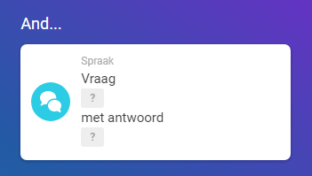

You can use this card in the AND column:
