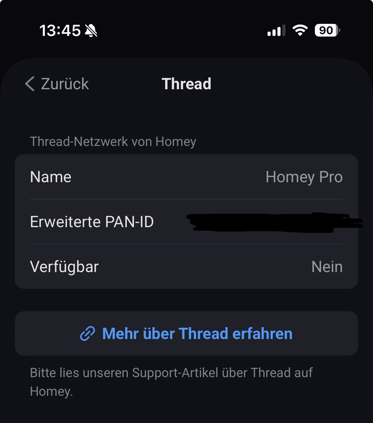

Where do you see that?
If you mean the following view, open it until it is displayed, then close the view again and open it again. Then the connection will be displayed as “yes,” right?
That’s how it is for me, anyway. I don’t have any problems with my thread network either, so I assume it’s a bug.
At first, it is displayed as disconnected:
Approximately 5 seconds later, it will be displayed as connected:
