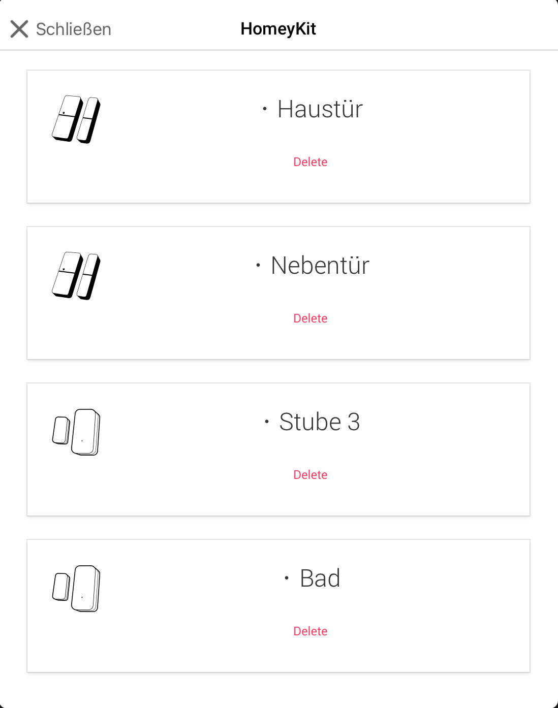

The settings of the HomeyKit app show all my connected devices:
