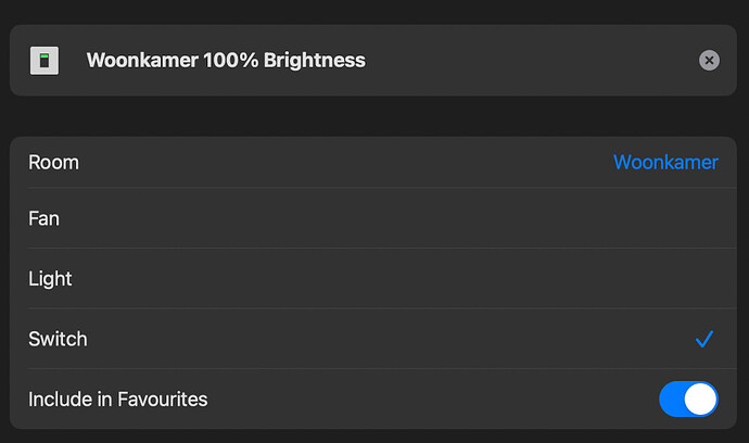

Not in HomeyKit, but perhaps in the Home app on iOS (although you don’t have much of a choice there either: switch, light or fan).

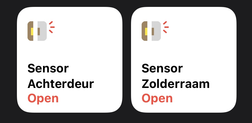

I have added a few new Aqara Doorcontact sensors to my DECONZ setup. They are responding correctly (and perfect) in the Phoscon webpage and in Homey (various flows).
But in Apple HomeKit, via Homeykit, they are detected as a general device and not as a doorcontact. See attached image.
My older Aqara Doorcontact sensors are working correctly.

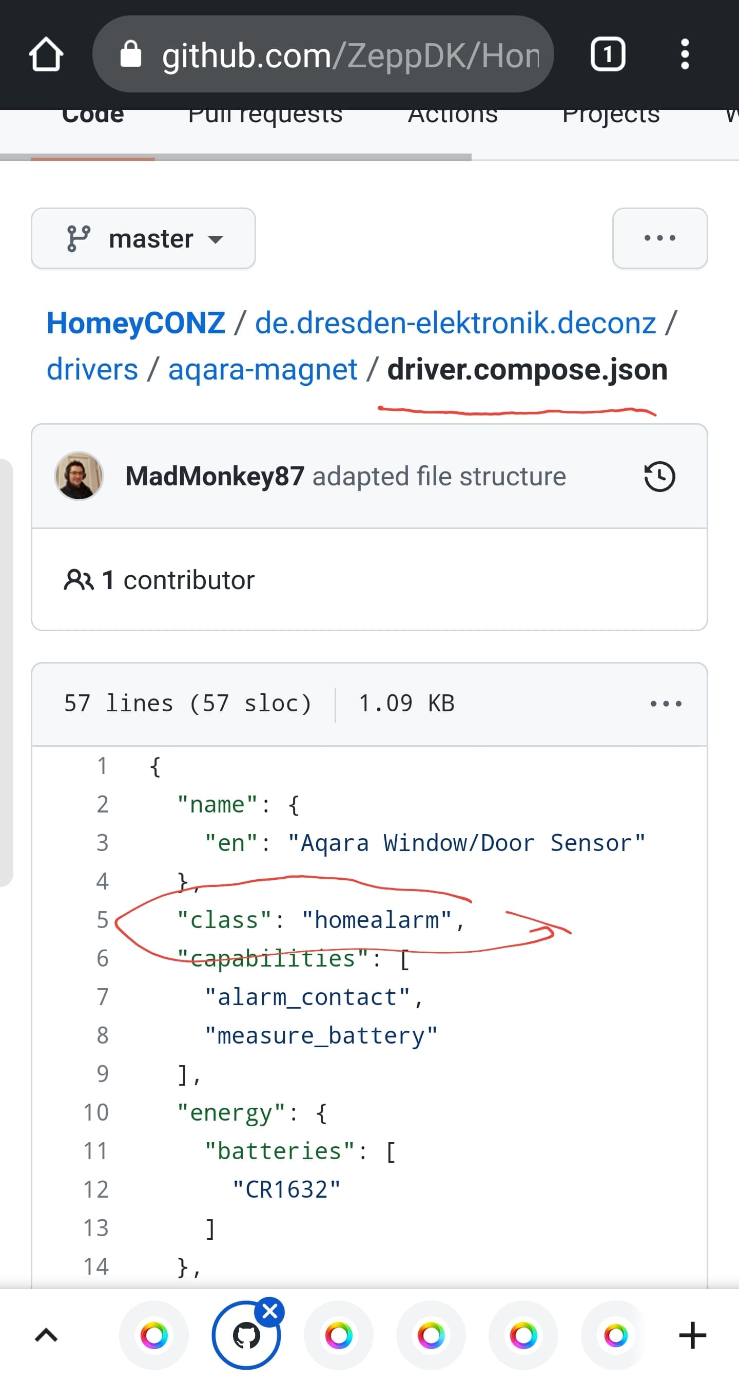

Yes, and that’s exactly the issue: the alarm_motion capability is only supported for sensor devices, not for homealarm devices. It doesn’t really make sense to use the latter device class, because that’s meant for home alarm controller devices, not for sensors that might be used to trigger an alarm but have lots of other applications too.
Thanks for the explanation @robertklep.
Is there an option to change this? If Yes, where can this be changed?
And ofcourse, if not… we have to deal with it.
It has to be changed in the app.
I don’t know why the deCONZ app is using two different device classes (but perhaps it was changed from “sensor” to “homealarm” between versions of the app and any existing devices that already used “sensor” were left unchanged).
In the HomeyKit app or deCONZ app?
In my opinion in the deCONZ app. Like I said, using the “homealarm” class for this type of device doesn’t seem correct.
Check! I will ask in the deCONZ thread if there is an option to change this. Thanks!
It is the deCONZ app I think
