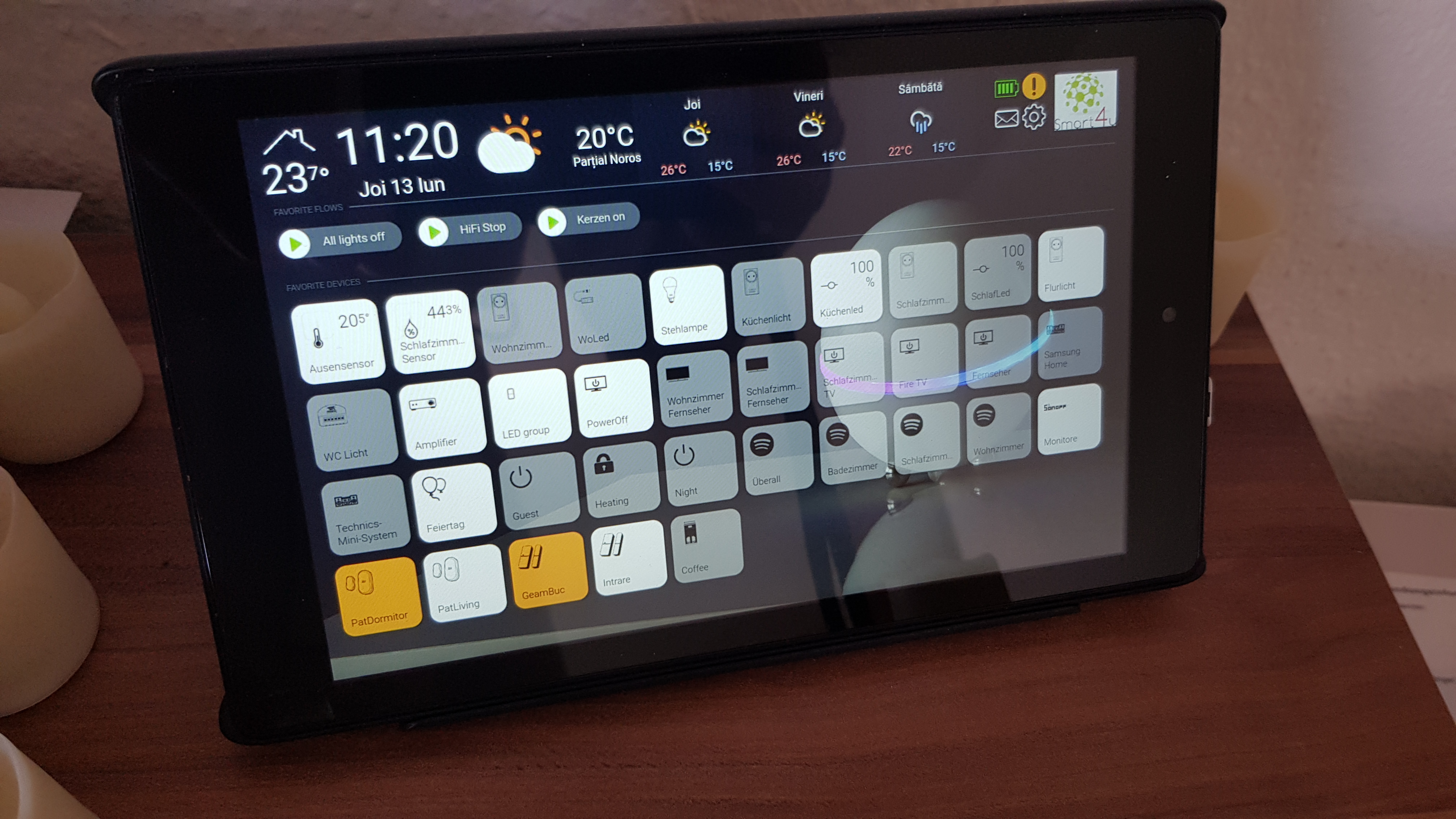

What have you done to the top to create Your own buttons for lamps and tv channels ?
You can use bootstrap for example

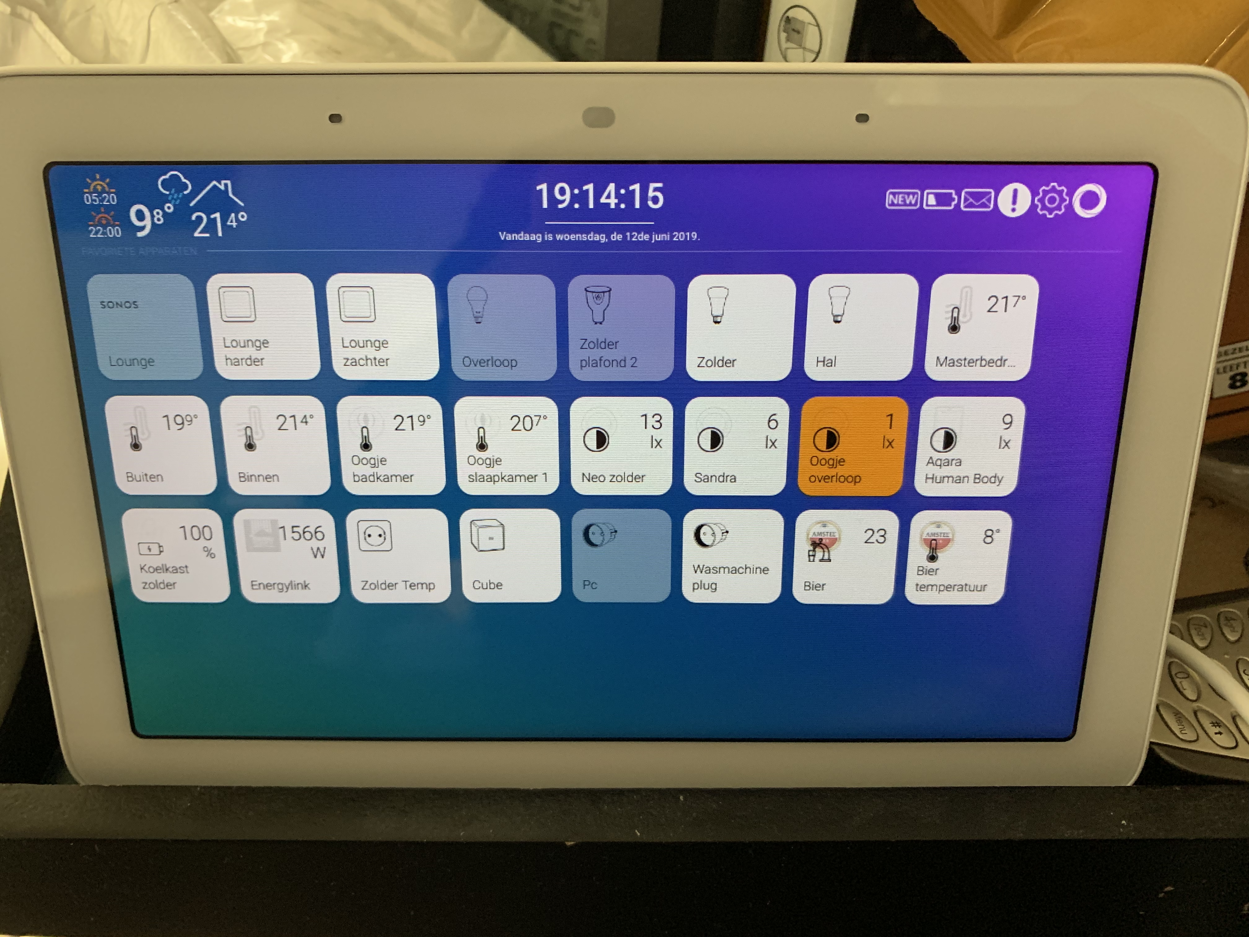

Homeydash.com on a Nest Hub.
Add the Nest Hub to ur Homey as a Chromecast device and call it whatever u like. After that make a virtual device ( i used the virtual device app from Arjan and added a light with just the on/off capability) and call it “Dashboard” . Then we make a flow with casting a website to ur newly added Nest Hub:
chrome_2019-06-12_17-46-32
chrome_2019-06-12_17-46-10
Then we can say “Turn on the dashboard” and voila!
Can you also control things on the nest hub, or only show the dasboard?
U can control the tiles yes! It has a touch screen so turning lamps on and off and show the temperature on the tiles works like a charm!
O wauw… thanx for your replay… I think i’m gonna buy a nest hub if i can controle everything… I whas thinking to buy een normal tablet for the dashboard app but the nest hub whill be much nicer ik think :slight_smile:
