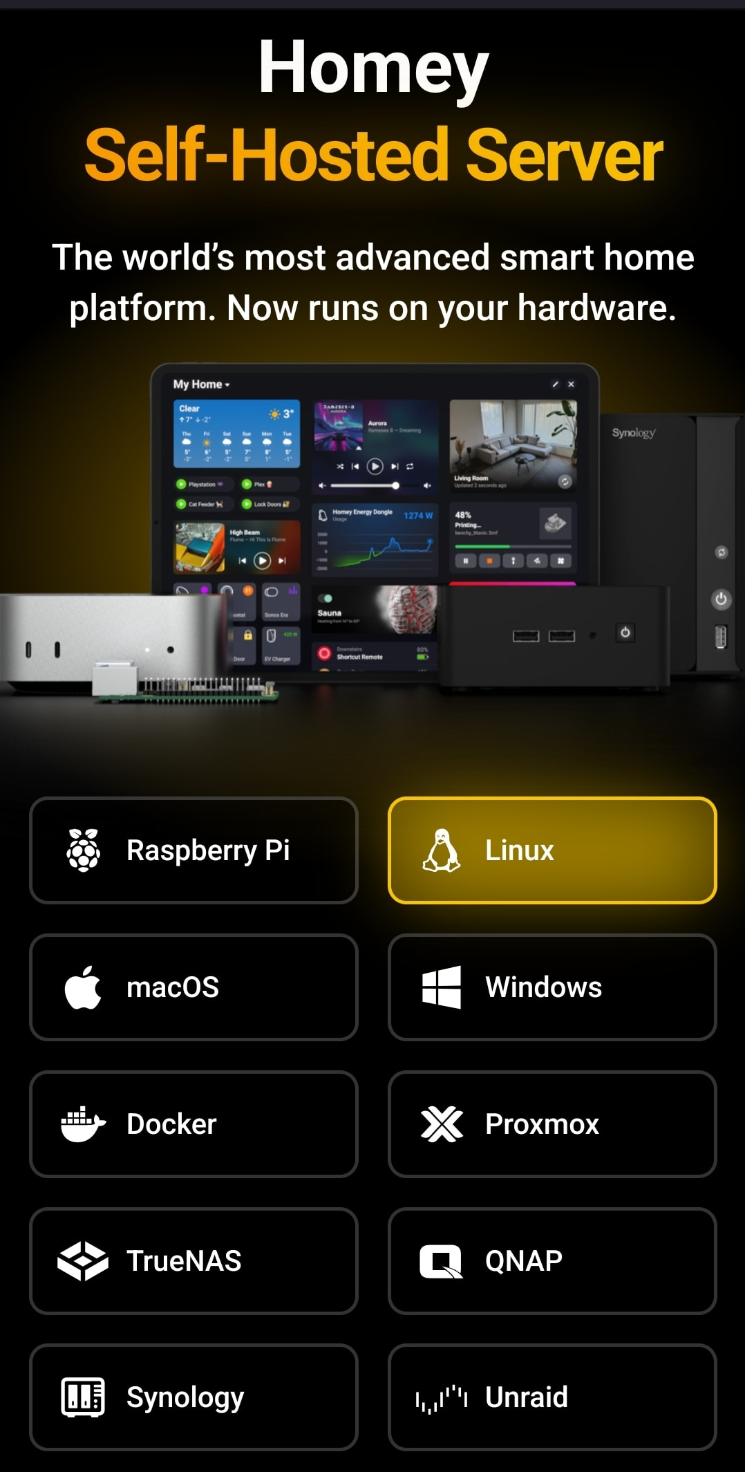

50 shades of Docker…
Dissapointed to see that this is also, like all other options, just Docker…
A container inside a container is a bit redundant.
Would much prefer a native Linux version without Docker.
But it’s there as well?
You would think so, but it is just another Docker install.
To specify, I would prefer a non-Docker version. But I understand why they went for Docker, so I don’t expect this to change.
Ah I see. Then I don’t quite understand why they distinguished the two as linux and Docker.
