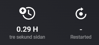

See https://tools.developer.homey.app/tools/system
Uptime (Seconds since last Restart)
No history by default, (unless Homey Reports it did a Firmware Update on your timeline)
but you could create a Flow for it :wink:

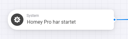

I tested this action, but this card doesn’t seem to trigger anything.
Is this the only system card there is?
This is an Trigger.
Have you tried the example above? Did that work on a restart of Homey?
For me the trigger card is working.

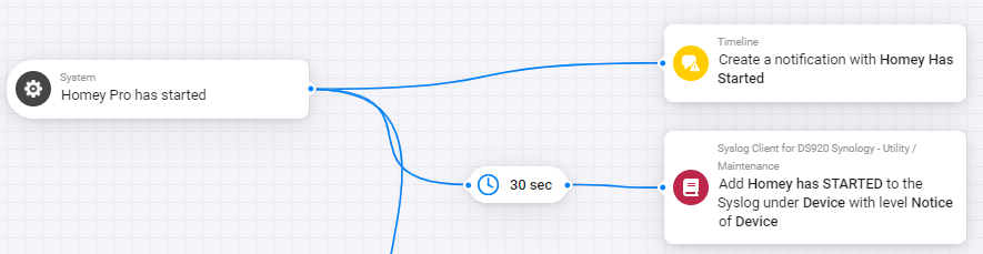

Reboot Advanced flow:
Homey has started Advanced Flow:
I log to the timeline as well as to a local simplelog and a remote syslog
You can use the SimpleLog app: Simple (Sys) Log App for Homey | Homey
My setup is slightly more advanced, since I am also running a centralised syslog on my synology. But if you drop the two cards that say ‘DS920’ your flow should still work locally on you own Homey.
Remember that when using apps, also logging apps, they need some time to startup. This is why I have the 30s delay after the reboot. Experiment with timing on your local device to make sure this works properly and you don’t encounter that SimpleLog has not started yet. If it does not work, increase the delay.

This is the flow. All I want to do is log the restart of the Homey:
I want to use easy logger for logging through api and google sheets.
Tried with 30 sec delay, but I didn’t get anything.
Not sure what is the issue here. How about you start with a 5 mins delay and see if that works.
If it does work, you can reduce the timeout/delay; otherwise increase the delay.
Perhaps try using the timeline as well to see whether your flow or the timeout is the issue.
