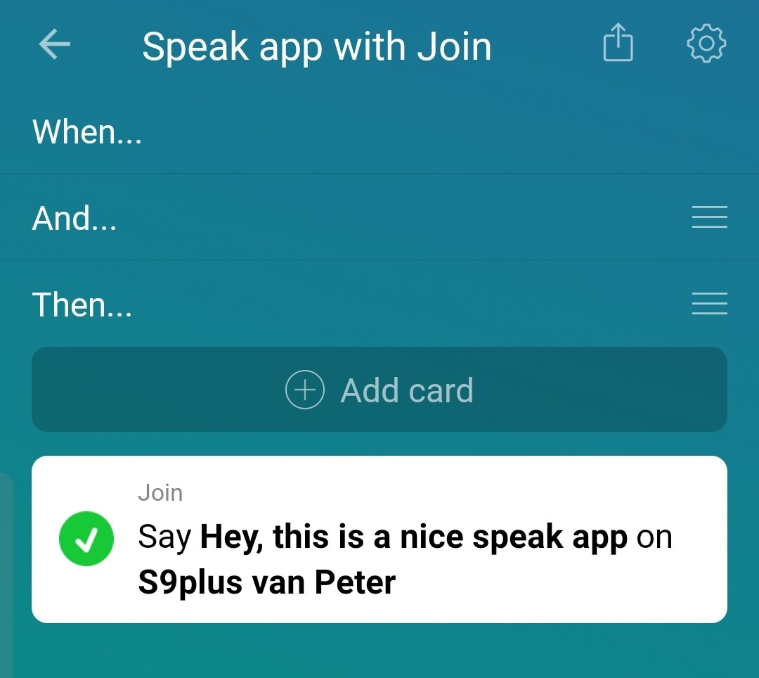

Might be interesting:
I stumbled on the “Join” app and it lets my (Android) phone speak up:
Should work on Pro '23, but I don’t own one
Thank you, @Peter_Kawa for the suggestion. On this moment i got it working with the help of macrodroid app on my phone and with webhooks. But it is not easy. I will try this one day.
