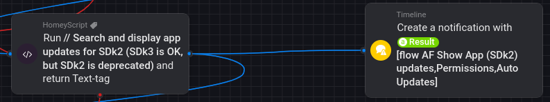

This is also possible
Use a Homeyscript THEN card, ‘run code and return text-tag’
The result of the code becomes available per the ‘Result’ tag, which you can put in a timeline card or such.
Paste the code below into the card, and run this every day or so.

return 'Your SDk2 apps (with available Update):\n' + localTime + '\n' + appUpdates;
Yes it’s my Homey. I don’t believe it gets slow because of many flows.
Look what I did with a 512MB (non)Pro, and it was not dead slow:
